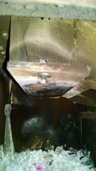

    I'm getting tired of losing these hitch pins that hold up the cat scoop screen in my Keystone.
    After a few weeks of burning these hitch pins wear out and get banged around by splits and eventually fall out. I had the whole basket drop down on me once so I'm trying to think of some better way, any ideas? Maybe a different pin or maybe change out the posts for something with threads I can screw a nut onto?

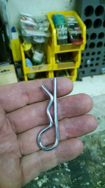

    Here's the hitch pin that goes through the posts the hold up the scoop screen.

    What's the material?
    Wondering if those are available in stainless steel, and if they'd last longer?

    Can't find s/s pins locally but I've had them when the stove was new and they didn't pan out any better.
    Maybe if I drilled out the hole in the post and used a thicker heavier duty pin? They just seem to loosen up over time and slide out.

    Maybe a ring cotter pin? A roll pin would definitely work but might be a pain to remove.

    I've only had one fall out in the 2 winters. I just stuck it back in. The OEM pins are stainless.

    These would be good but they would have to be smaller diameter. Maybe you could find a smaller one or else grind the shaft down on a bigger one and/or enlarge the hole in the stud?

    Or maybe use the standard one. The problem is they don't lie flat against the scoop, so maybe you could bend the loop end so that it would be centered with respect to the post, instead of the entire loop on one side of the post, where it can hang down. Another thing would be to bend the straight pin end so that it takes a bit of force to push it through the hole in the stud.

    WS going to send me some standard pins. Maybe its the cheapo pins I get around here. I put a bigger size in than I had before, maybe that will help.

    Todd, a quick and easy fix is to wrap wire about the bottom of the pin. That is, where the last crimp is near the bottom. It won't come out then.

    Go to HF and buy their cheap cotter pin assortment. Just like on the hearthstones. Shove it through and bend the end over. Done. If it fails after repeated removals then pop a new one in.
