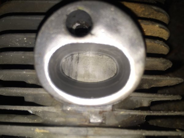

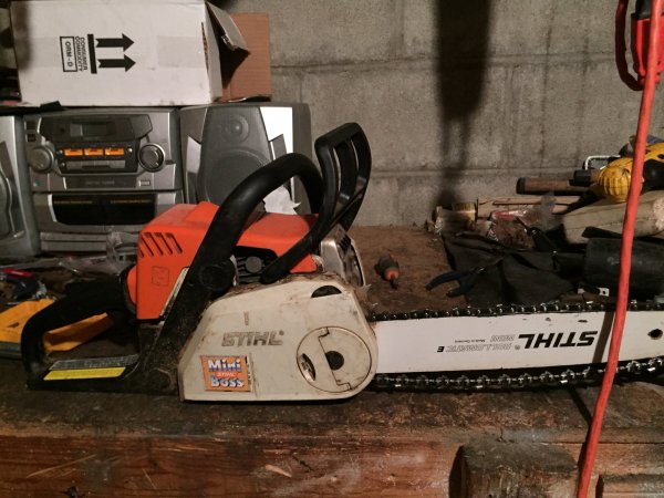

    image.jpeg image.jpeg image.jpeg Well guys a couple weeks ago I bought a ms180 that ran very poorly....I paid $40 for this saw that has a 14" B&C, a ms180 carcus for parts, 4 good 14" picco chains,2- extra 14" picco bars, and 3-20" RM chains for my ms362 that have never been re-sharpened.....I was happy with this deal anyway!!!!
    So I get home start the saw and as the guy says, saw runs but poorly.... So into garage I go, take off muffler and as suspected, piston is scored pretty badly..... So I get on the net, and start looking at parts, and decide to just get a whole engine assembly....I find a decent looking AM engine and get it shipped to my door for $48....well after some cussing I get this "clamshell" saw apart....I put the AM engine in and she fires right up for me.... I have now ran about 2-3 tanks of gas threw the new engine, and she seems to run great..... I have cut some 10-12" ash and the saw actually cuts threw it pretty good..... I thought I was goin to sell this saw, but my CAD is telling me to keep it, I mean it is a very light saw that would be just perfect for limbing......anyway not the most exciting rebuild, but was fun for me none the less!!!

    Looks like you got it turned around quick.:thumbs:

    Nice job on the rebuild. Now mod the muffler and slap a wt 215 carb on there for mo powah!!! :dex::saw: Whole new machine. Did you figure out why the piston was scored in the first place?

    Well judging by the way this fella took care of his stuff I would say old or bad gas... Good thing another the whole engine is it replaces seals and all.....

    Scoring like that us usually caused by some sort of lean condition. Might be worth going over the carb. I'd hate to see you wreck a new motor.

    It looks like it scored from carbon buildup/crud around the impulse pipe.
    The intake boot covers the impulse pipe IIRC?
