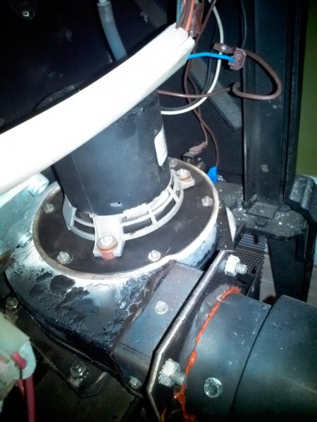

    A few minutes ago the mrs yelled to me in the other room that the stove was smoking. Soon as she said that the smoke detectors went off. I quickly turned the stove off and opened the windows. Smoke was rolling from the back of the stove and I could hear stuff falling in the pipe. I ran outside and looked at the pipe on the roof and there were a few sparks coming out. The stove cooled down enough for me to pull the back panel off and it looks like the paint burned off the exhaust fan housing :eek: . Any idea what could've caused this? My chimney is clean so I don't think it was a chimney fire. The stove was burning on level 4 at the time this happened.

    Yowza!!!!! First thing I'd do is pull that blower but be careful not to rip the gasket....unless you have another one on hand.

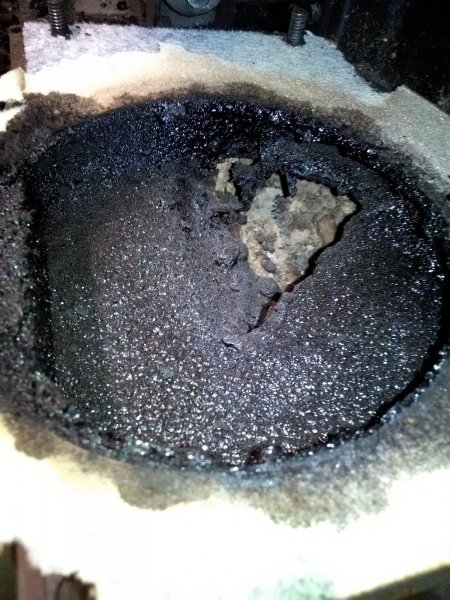

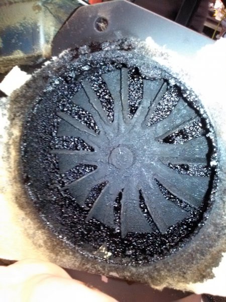

    Well i decided to take the mrs and baby piney out to dinner and let the stink clear out of the house for a bit. We just got back and i removed the exhaust blower (since i had 2 extra gaskets) and it looked good inside. After staring at it for a few minutes it dawned on me! When i was cleaning/rebuilding this stove, there was a build up of gooey creosote in the lower part of the exhaust housing and some inside the upper housing. I scraped all that i could off and burned the stove on level 5 for a good while outside. Assuming it burned the remaining creosote off i left it alone :picard:. All i can figure is that the creosote was still inside the housing and finally lit off tonight after running on level 4 for about an hr. Im also burning some greenway pellets instead of the softwoods i've been burning. They do seem to burn a little hotter.
    The stove is back together and burning on level 2 right now with no paint smell and all seems well. I'm keeping a close eye on it until we go to bed and shutting it off like i usually do. Im definately glad we were home when this happened. It could have been ALOT worse. I was just getting comfortable leaving the house with the stove running. Not anymore! :emb:
    Here's a pic of the exhaust housing before i cleaned it. Trust me it looked alot better when i put it back together but i guess it wasn't cleaned enough.

    That's the snap disc on the exhaust blower housing? If it got hot enough to melt the paint it should've shut the stove down right?
    It was the cooling fan on the blower blowing the burning paint smoke up the back of the stove. Filled the whole dang room in a minute!

    What does a change in the ash color or dark spots mean? I do my best to keep this stove running clean. Those pics of the blower housing were before i even installed the stove. That was buildup from the previous owner. I tore this stove down and cleaned the crap out of it before i installed it but that little bit of creosote that i thought burned off during my outside test burns must've still been there. :picard:
