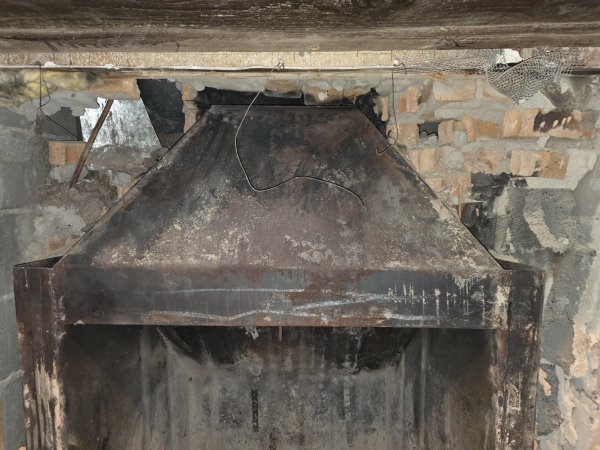

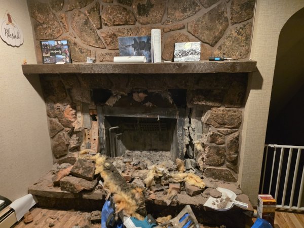

    It took a bit of Jack Hammer work, and I will tell you, I feel 50 coming on. And with the missing leg, it seemed a lot harder this time.

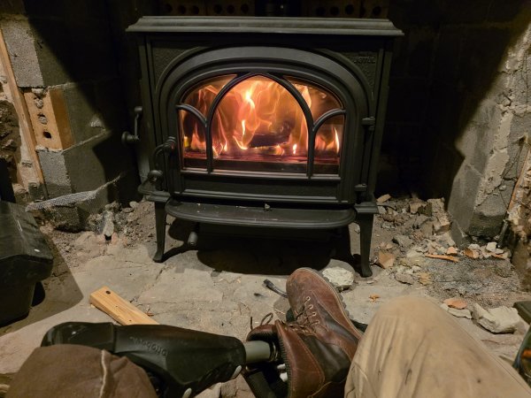

    Two nights of jack hammer work, the top photo was night one. In night two, I had this steel firebox removed. It did not take much longer to get the flue liner set in place, and the stove set in the new hole.
    I ran the first break in fire, nad unfortunatly I hit 600F on the thermostat. I am waiting for it to cool bow and will try a smaller fire for break in burn two. It will be a late night, but I would really like to go to bed with a full stove tonight.

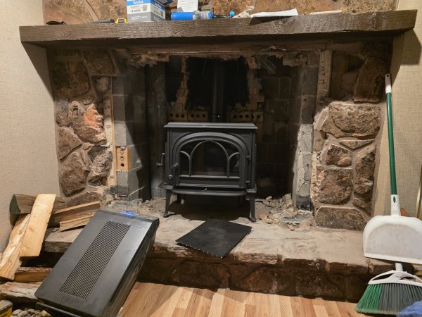

    So what do you think we should use to decorate the back?
    Should we extwnd the base and have the stove stick out more?

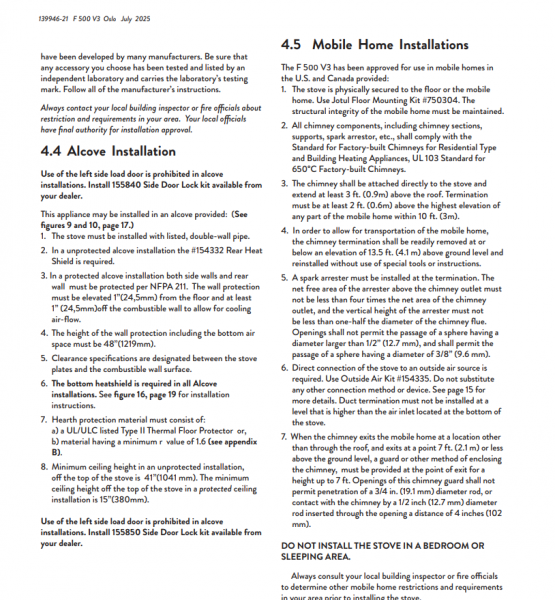

    Does the 10" height from the wood floor count as part of the 18" requirement in the front?
    Would you extend the pad, or tile the floor?

    Maybe a fire proof hearth rug?
    Handsonautotech and Eric VW like this.
  3. Eric VW
    24,391
    140,324
    Welcome back Handsonautotech! What a way to pop back into wood heating and FHC action!
    Like wildwest suggested, a hearth rug/ fireproof mat would be the ticket, especially to keep the momentum going…. You could always back up and punt after the heating season is over.

    This is a really good idea to buy me more time until we decide on the final solution, thank you.
