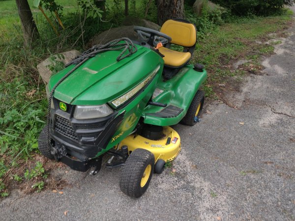

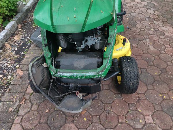

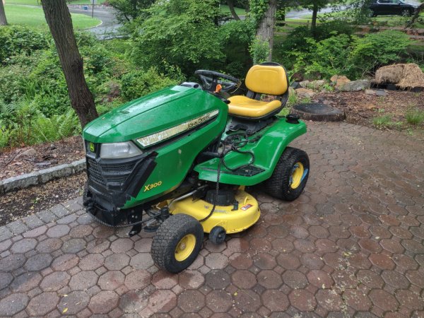

    So I got this ride on mower for free from my neighbor just down the block. A bunch o' problems with it but I'm down to tinker. John Deere X300. Has a hydrostatic 17hp twin-v engine.
    1. Rear tires flat.
    2. No oil
    3. Half a tank of old yellow varnishy stinky gas.
    4. Front fascia that holds the lights has 4 broken clips (was held in by gorilla tape)
    5. Dead battery that won't charge.

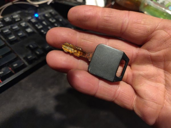

    6. Key rusted.
    Tried to siphon the fuel out but failed. I think I'll just disconnect the line at the fuel filter and drain that way.
    My plan is to get 'er up and running and then figure out if I'm going to sell it or buy a used snowblower attachment for it. I'm getting kind of sick of the walk behind snow blower but I don't have a 300ft driveway to do either.
    There was blue tape all over the valve stem of one of the rear tires. I may need to replace both tires. Also it was left outside in the elements (hence the rusty key) and the paint is all faded and mildewy. If I'm keeping it I'll paint the thing with U-pol rapor truck bed liner, the same stuff I used on my step rails on my Tacoma. I think it will look sick.

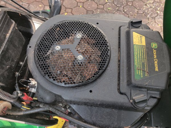

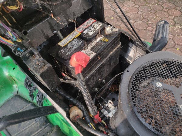

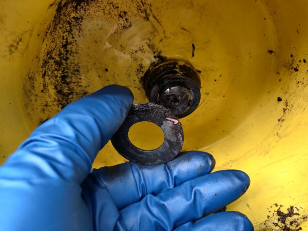

    The fan was all caked up with crap. I put the washer on the wrong side - I'll fix that. For now I can get a battery at Home Depot for $40, a fuel filter, put some oil and gas in her, and see if she fires up.

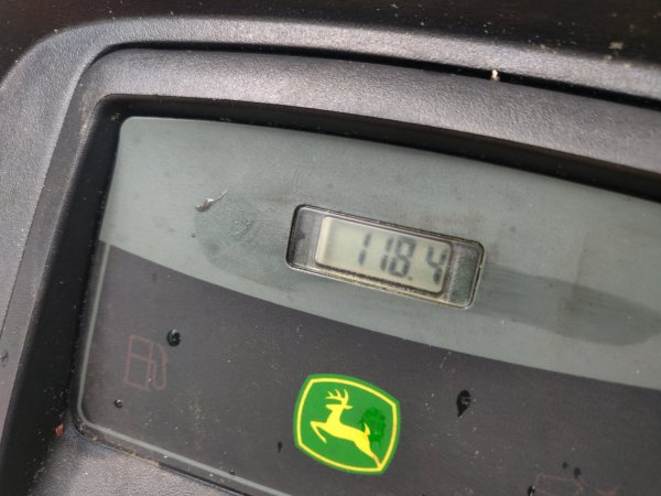

    It's a 2006 with only 118 hours on it. Took a closer look at the engine cover and it's cracked at the pegs which are built into the plastic. Stupid design. Fascia also cracked. JB weld may do it. Not sure.

    This is what happens when you don't take of your equipment and just leave it outside. I think he let his kids drive it and they probably smacked it right into a tree.

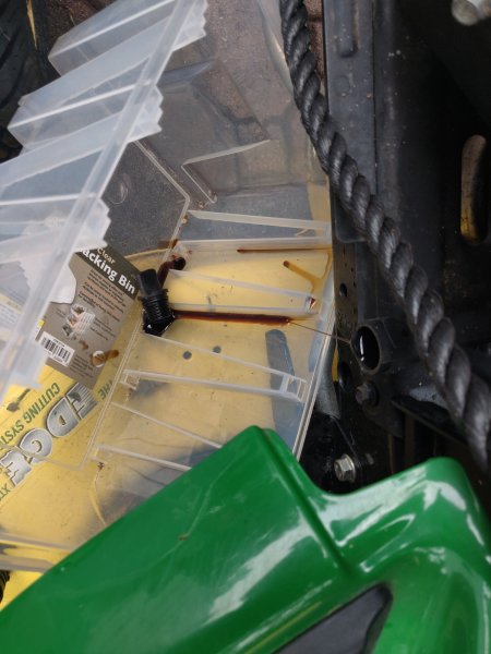

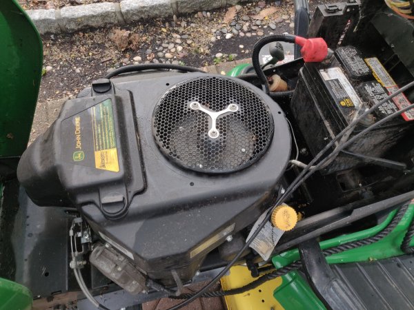

    Got it up and running! The fuel stank and I thought I would need to drain it....but it really does purr like a kitten. There was no oil in there so I flushed it with a little fresh oil and added 1.8 quarts (or so) just to see if it works.
    Battery was dead so I jumped it with the Mini. I didn't move it yet because the rear tires are shot but I think we're in good shape here.
    This is what came out when I opened the oil drain.

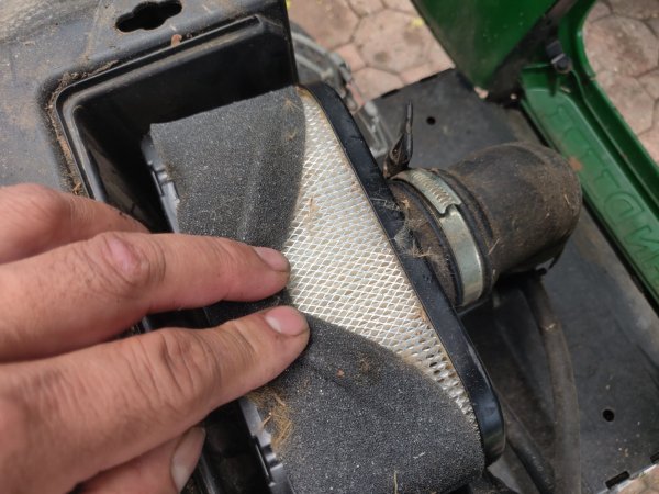

    And the air filter looks almost brand new.

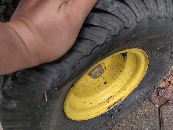

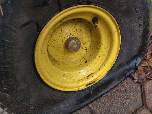

    Dry rot on the tires. It's bad on both rears. I'll have to replace them for sure.

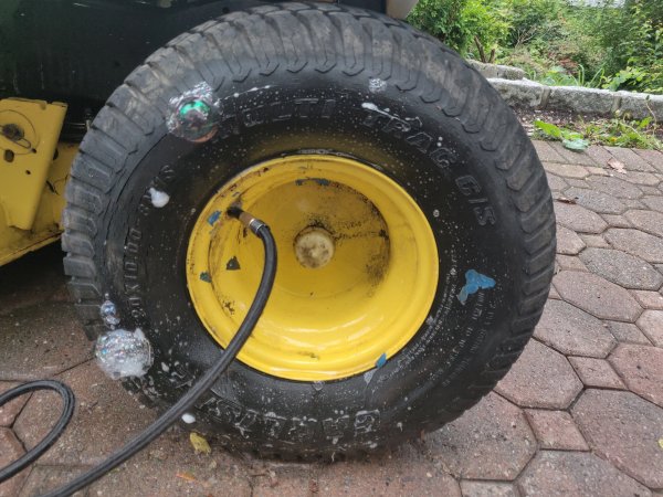

    Tires are shot. And this was the good side lmfao. Valve stem leaking like a sieve. 2 holes from dry rot.
    20x10. Anyone here ever replace them yourselves?

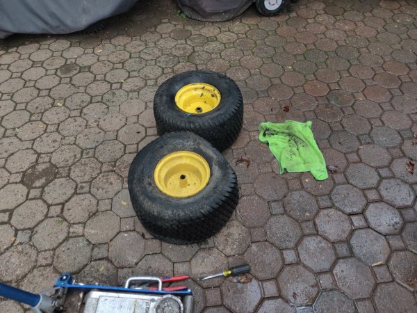

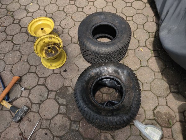

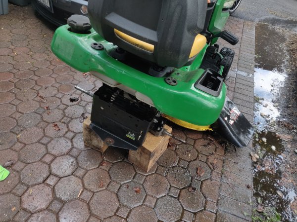

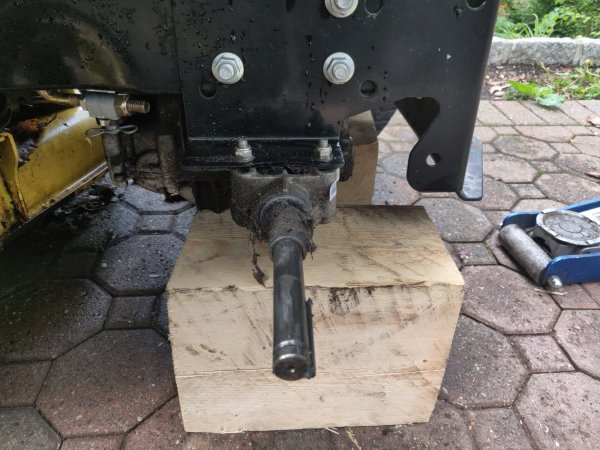

    Removed both wheels. Removed both tires. One had an inner tube, the other did not.
    I don't know the transmissions work in these hydrostatic machines. But when you turn one axle it spins the other one in the opposite direction. I'm not sure how the parking brake works either as it doesn't seem to prevent me from spinning either wheel.
    That was the first time I ever removed a tire from a wheel. I did ding up both rims when I smacked it with a sledge to get the bead to unseat. Oops. I'll try and un-ding them.

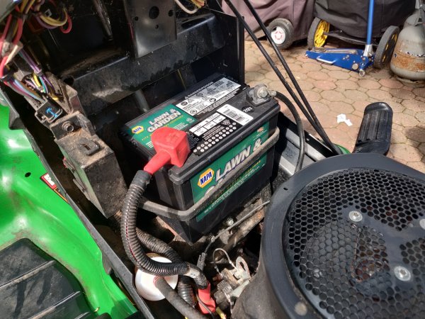

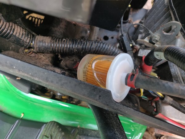

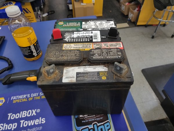

    Got a new 350CCA BCI U1 12v battery for it at Napa. New fuel filter. Aw yeah!
    Local dealer wanted $89 for the JD battery. This one was $74. Perfect fit.

    If you’ve already done this, apologies in advance. Pull the shroud off the engine and make sure that critter didn’t build another nest or remnants of the nest didn’t migrate. Or, maybe the critters remains are still in there. I lost a Briggs engine once because a mummified mouse was in the shroud; then grass packed behind it and blocked the airflow. Piston seized in the cylinder, crank snapped and cracked the block.

    Yeah those suckers were both leaking out of the sidewalls and had massive dry rot and had been sitting flat for a very long time. Out of fairness to myself and the possible next owner I'll definitely have to get new ones at least for the rear. 20x10-8 is the size I need and saw this great video talking about the different treads one could get.
    Yeah that was the first thing I did and yes there was a bunch of debris in the fan. Took a few minutes to pull the 3 torx bolts and then vacuum and blow out the junk. It wasn't that bad but there's a pic of it in my first post. I saw a video of Andrew Camarata where he picked up an old Craftsman ride on mower and there was actually a live mouse still in there! Timestamped to the action.
