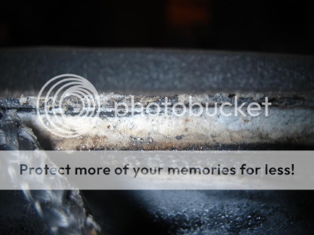

    Heading into town to grab door gasket and was wondering what people do to get the old Gasket Cement outta the grooves?
    Thanks eh!

    Chisel or flat head screwdriver is what I use

    I believe I scraped the slot with an old blunt screwdriver. In some places I would need a block to chip some chunks out.

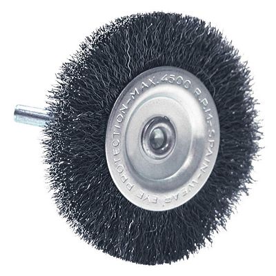

  4. papadave
    I've used a screwdriver, chisel, wire wheel in a drill........and a combo of those.
    That looks like the same gasket cement from Imperial that I've used. I don't much like it, because it foams up and flakes off when heated.

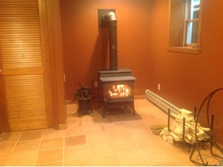

  9. Jack Straw
    Jack Straw
    8,396
    52,391
    30 miles west of Albany Ny
    Well, I got the new gasket in. ;) Now it's time for a fire.
  10. Scotty Overkill
    9,614
    64,519
    gorgeous....love that nook and the stove in it!!

    Up and running Jack and yours looks great! Had some help from 'Buddy the Blurr' :D Also over analyzed the old glue as it came right out with a #8 squarehead driver :yes:
