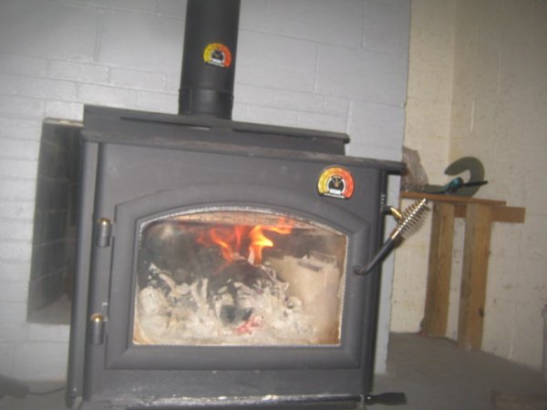

    Four hours into the burn and still rolling along on three splits. The difference between last years wood which was C/S/S for 8 months as compared to this year's wood at 16 months C/S/S is amazing. Longer burns, using less wood, higher temps, no smoke coming out of the flue, much longer secondary burns.

    That's lookin pretty good Mitch! What type of wood was that?

    Four hours later on 3 splits, and what was the stove temp?
    I can't quite tell in the pic.
    Have you tried placing the stove thermo on the riser just below the flue?
    I have an older steptop and that's the hottest spot on the stove.
    Just a suggestion.
    Oh yeah, it's the wood.:thumbs:

    I believe all three splits were Ash.

    I think the thermo shows just a little over 300. Which was fine cause up stairs the house was 71. But it held at over 300 for several more hours til I re-loaded for over night. AS you can see in the picture the front air control is all the way down. And when I re-loaded, it was only four splits. With better seasoned wood I don't have to over work or over fill the stove at all. I've been checking those cheap thermos with the IR gun and they are right on. I have set the thermo on the riser and the hottest part of the flue is a little higher than that on this stove.
