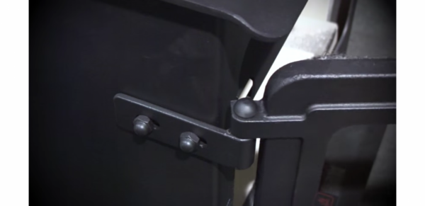

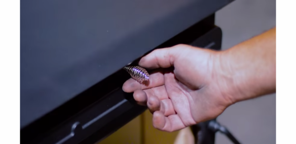

    Kimberly, take a look at this video. At about the 28 second mark, note where the rod and spring are above the door. At the 1:07 mark, it shows very clearly that the spring handle clears the top of the door, by quite a lot. Perhaps they sent a spring that's too large. There are two on the 30.....one for the door handle and one for the air control rod. They're different sizes.
    Looks to me like it's slightly higher than yours.
    concretegrazer , looks like they can only be adjusted in or out, not up and down.

    And that video gives some pretty clear shots of the door hinges...do your hinges look exactly the same Kimberly ? Maybe a couple pics of the hinge and latch area...

    & a shot of what the rod clearance should be.

    This is a pic of the 01, but is probably similar. Looks like the hole should be higher on yours.

  11. brenndatomu
    25,097
    163,035
    Just eyeballin it, the damper rod in the video appears to be about the same distance below the top...
    But the door seems to be much higher on hers...wonder if they could have bolted the wrong hinge brackets on?
    concretegrazer and papadave like this.
  12. papadave
    Yeah, could be the hinge attachments got welded to the stove body a bit high.
    HDRock likes this.

  18. HDRock
    17,262
    60,487
    Something sure isn't right, shouldn't be like that.
    Looks like the hinges just bolt on
