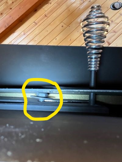

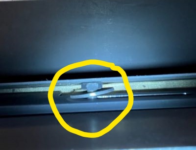

    I gave my stove a good cleaning today, and thought I'd check a few things out while it was out of commission. I checked the air wash bolts and noticed they were way loose. If it wasn't for the stove they would have come out completely. I didn't realize how sloppy my air wash lever had gotten. It's on my radar now. I guess I need to relearn my air flow... :whistle:
    It does pay to inspect everything now and then. :binoculars:

    You would never suspect a faulty setup from the dealer or manufacturer, and it's good you have enough experience to recognize it.

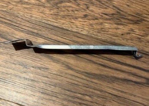

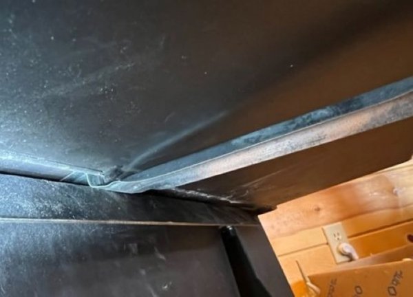

    My stove temps have run up on me a couple times lately (probably playing that tetris game.. (eye roll)). Manually controlling the air on my stove is limited to the air wash above the door. The air inlet at the bottom front doesn't have any control, so I thought I would make a tool to choke it off when my stove temps appear to be challenging the surface of the sun.
    The pics shows my prototype tool, and where it will be placed between the ash pan and stove to choke off the bottom air inlet. My initial test is promising.
