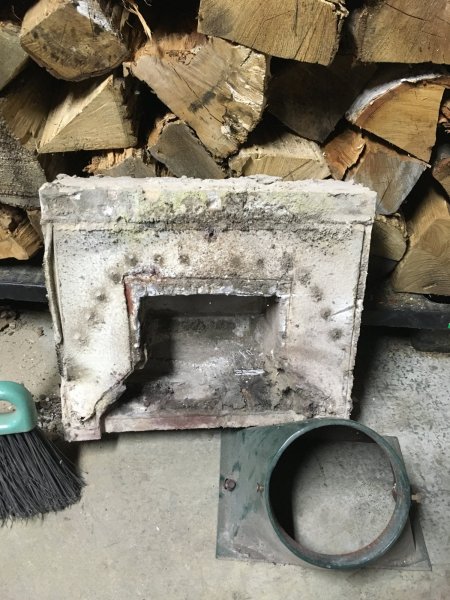

    CF52862B-BC22-494F-9A11-770C96C0B220.jpeg This Jøtul came with the house. Unfortinitly looks like the insides are pretty toasty to say the least. I’ll bet it will be a step up from Warner the wood beast but is it worth it?

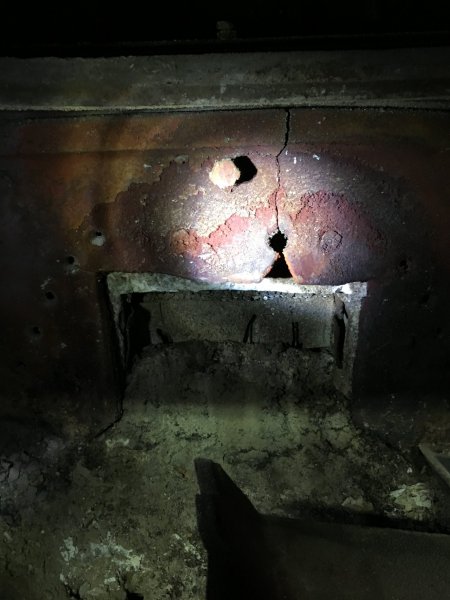

    Seems the insides are pretty burned out.

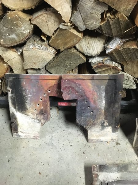

    A6ECD310-FD2F-4C33-8BAC-5BD6B5078385.jpeg Getting the wood beast going after work I kept looking over at the jotul. I said what the hell why not. The bolts have come out much eaiser than I had expected.
    The fella that I talked to at the local dealer seemed to want to sell me a new stove rather than parts. Anybody have any suggestions where to get parts?

    The combustor is busted, the back plate is torched and the damper assembly is sagged. Any help with parts location would be greatly appreciated.
