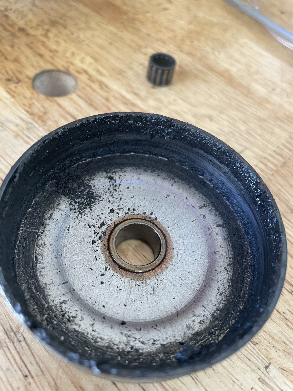

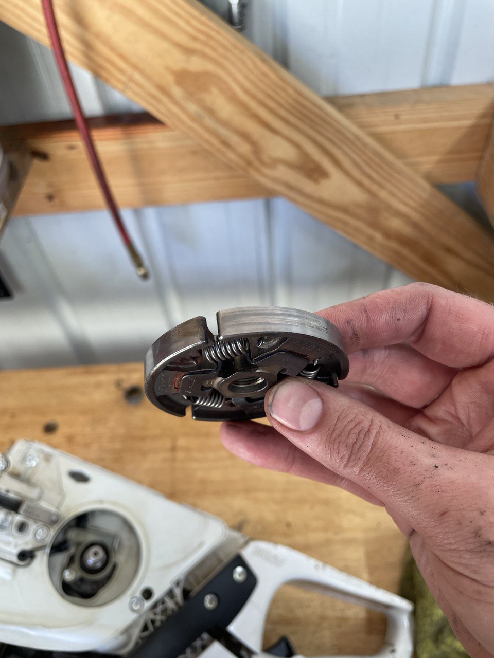

    I noticed my sprocket was very hot after a session and took everything apart. This is what I found:
    Okay this looks bad to me, but I know nothing about chainsaws.

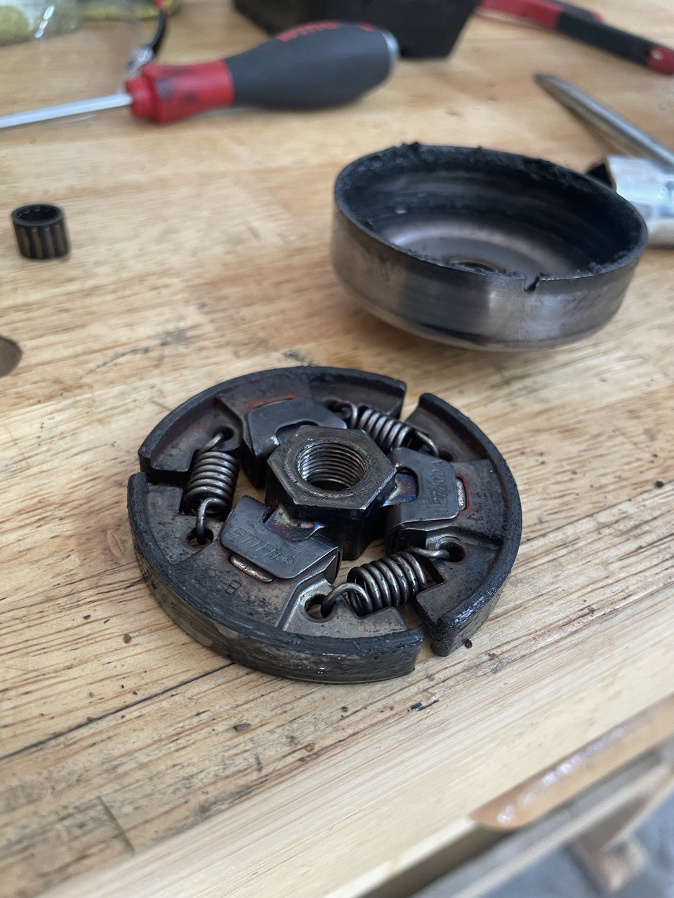

    I cleaned up the clutch:
    If I didn't know any better, I'd say all the friction material is GONE. However, when I look at a clutch for sale online:

    Basically the weight of those “shoes” make them want to fly off and they make contact with the drum to engage drive. Yours looks fine to me but.. there shouldn’t be all that black material in there? It should be dry, not a good place for any lubricant like WD or grease. Only place for a bit of grease is the bearing that sits between the drum and crankshaft.
    Use only compressed air to clean that area out.

    Okay, after doing some more light reading online, it sounds like chainsaw clutches are all metal and don't (seem) to have a failure mode where the contact surfaces wear down, in general. One post on arboristsite mentioned a wear indicator which would be good to know where that is.
    I think my takeaway is my clutch is fine. I'll wait for some other folks to chime in though.

    Typical for the drum to wear thin, not the shoes.
    Needle bearing is only being used (so to speak) while at idle. When clutch is engaged, drum is turning w crank 1/1.
    Your lubricant caused a bit of slip, generated heat and made things black. At least that’s what I see.
