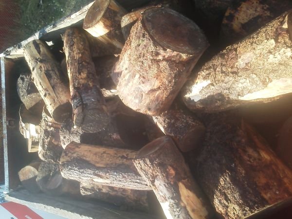

Is this 2 and a half cord?

    Looking at the box of the truck. I doubt it is 2.5 full cord. What would you say the dimensions of the box of truck are? Looks closer to 2 cord to me, but I don't know the dimensions of the box of the truck. It looks like box is 10' long. (not including gate) So I see about 2 lengths of 8'x4'x4'. Let us know what you come up with after cut/split/stacked. Will you?

    Doubtful, more like 1 & 3/4 to 2 when css. Can you give any measurements? It might just barely qualify in "logger cords" as this takes into account loaded rounds as opposed to tightly stacked product. Keep in mind that a cord is defined as 128 cubic feet tightly stacked. 4X4X8' or any variant thereof. Hope this helps. A C

    I'm guessing a little more than two tightly stacked. Stack it loose and airy you might measure 2.5.

    I don't know size of truck but it is close by and $220.00 oak beech and a couple lengths of cherry.

    I'd say that's closer to 2 cord C/S/S, milleo .......
    either way, for that price and for the species of wood it is, sounds like a pretty good deal!

    I see a truck about 6 feet wide loaded four feet high and ten feet long. 6 x 4 x 10 = 240 cubic feet. A cord is 4 x 4 x 8 = 128 cubic feet. You have 240/128 = about 2 cords. There will be some increase in volume when you split it because you'll have a lot more pieces which means more spaces. However, logs tend to stack rather loosely because even logs like yours, which look fairly straight, aren't really straight, so there will be a decrease in volume when you cut/split/stack. I think the increase and decrease in volume will be a wash. I say two cords.

    At two full cord you would have $36.67 a face cord. Not bad at all. Of course you have the work of cutting/splitting/stacking. How cheap can you get wood all cut and split dumped in the yard?

    I would guess 2 cords but I have been known to be WAY off on my estimation skills lol.

    I bet when all CSS ,
    it's pretty darn close to 2-1/2.

    I would venture something shy of 2 cords. The smaller diameter logs will stack pretty tightly, even when split. Also you have to factor for shrinkage; green wood shrinks about 10% when it seasons.

    I say 2 and 1/8 of cord. No shrinkage factor at play.
