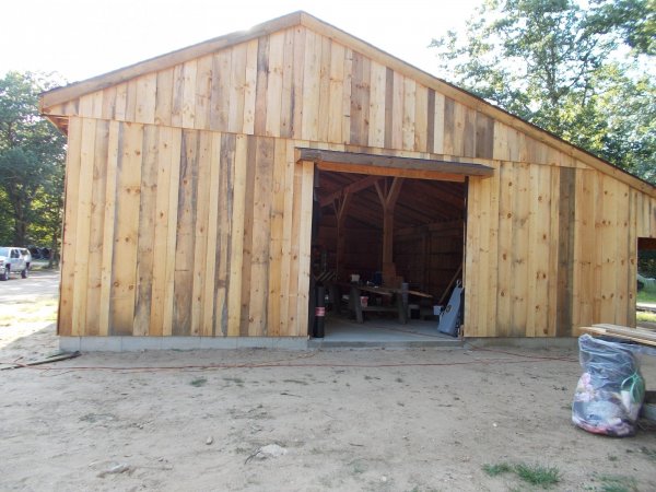

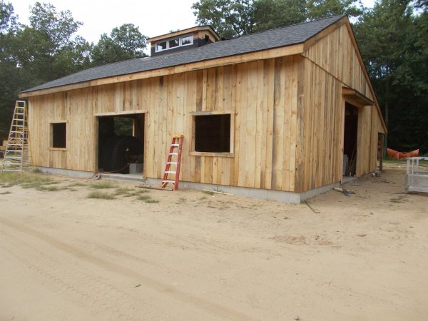

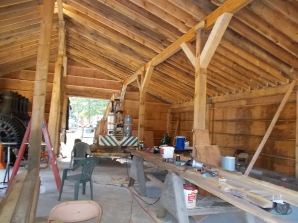

    here's a couple of pictures of our most recent building project. the building is 48 X 42 ,including the rear shed area. it stands 19 feet at the peak without the cupola.
    All the materials were cut on our 52" round blade sawmill except plywood and the two structural beams that span the center.
    just finishing up the doors in the next couple of weeks.
    here's a video of the mill in operation.
    milleo, savemoney, unclefess and 8 others like this.

    What in the heck is that big black thing in the left corner (of your beautiful building :thumbs:) with a huge looking flywheel and what could be 5? cylinders?
  16. artc
    artc
    Oct 28, 2015
    1,251
    8,628
    Rocky Hill, CT
    32 e14 fairbanks morse four cylinder diesel. 1938 vintage. Weights 24 tons. It will run again in 2017.

    the super size teeth are actually the outside of the alternator. when it ran, it produced 200 kilowatts of 480 3 phase power to support the fire protection system in the City of New Britain
