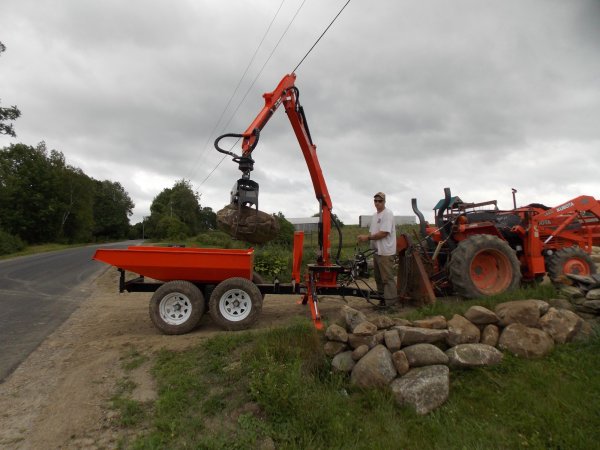

    Yes, kind of like the upside down wood splitter on the Bobcat pictured, but placed on my Wallenstein instead.

    Here is a picture of what I have, a Wallenstein Log Trailer, but with my log grapple being used in conjunction with my dump box. (It comes with a back hoe and post hole driller too).

    Okay, so what I envision is this. Weight wise, my Wallenstein can handle a splitter and any size block of wood I can split. What it may not have is the pressure and flow required to actually split the wood. (My powerpack was still on order when this photo was taken). So I envision running the log loader part with the power pack, but driving the upside down wood splitter by PTO pump, external hydraulic tank, a control lever by the operator and run hydraulic lines to the attached woodsplitter. In that way I can get my flow by throttling up or down my Kubota tractor while running a fairly big piston.
    The wedge would be a 4 way one.
    My dump body...it would have to have plywood sides on it so I can get more wood on it.
