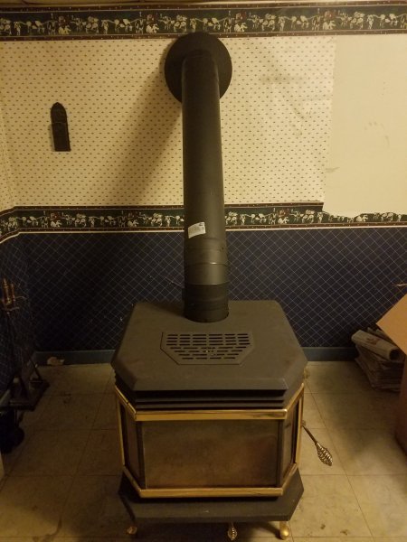

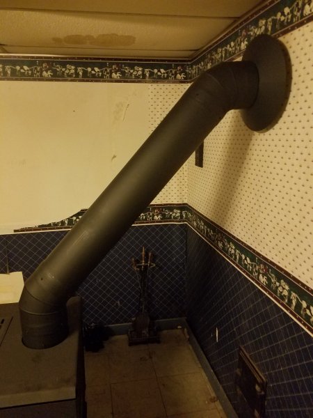

    I have an Osburn 2200.
    It exits from the top, then I have about 5 ft of double wall stovepipe at a 45* angle, about 19 inches through the wall, then out to the chimney which has a new ss liner and is a 16 ft 6 inch run straight up.
    I have an ash pan but dont have it installed.
    I was burning cherry but am now burning highly valuable black walnut. Admittedly my wood is a bit marginal this year as far as MC.
