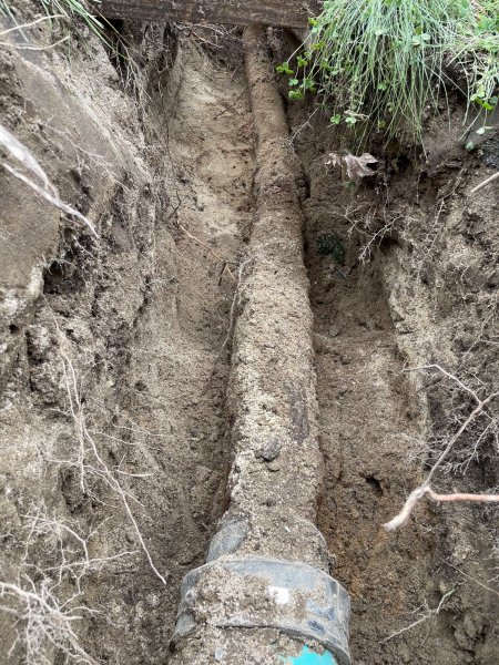

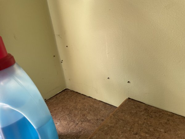

    Been crazy here for 1.5 years with drain flies in the basement bathroom! At first we tried the baking soder with bleach and put so much in the kitchen drain, the PVC pipe clogged like I have never seen in my life! It took 3 days with a professional drain snake to clear the drain! Background is that most drains and water pipes in the house has been changed to PVC. The septic tank was changed to sewer by the town about 30 years ago. There is however a 10 foot section coming out of the front foundation that was the old 4” diameter cast iron and after scoping the pipe, we found a sag with standing water in it about 4 feet from the front of the foundation!!
    See this $250 video!!
    We also put 3/4” stone and bricks under the née PVC pipe to keep it from sagging. We also added an outside cleanout too!
    Will this stop all those pesky drain flies from coming out of the clothes washer drain, the sink drain and even the toilet??

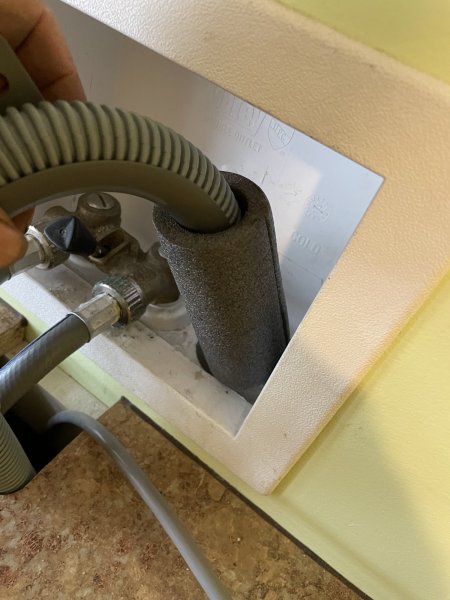

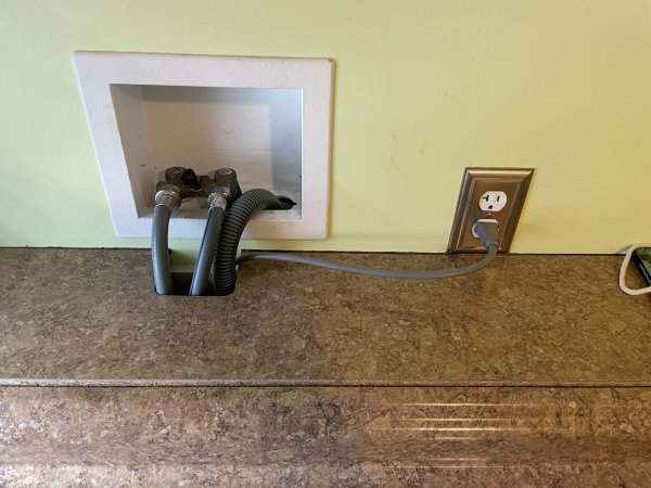

    Do you have a trap on the clothes washer line?
    If not, can close the gap around the drain hose where it goes into the wall box? A piece of foam pipe insulation to fill around the gap.
    I've seen drain flies appear when traps dry out. If not a frequently used bathroom, run water maybe once a week to fill traps.

    That sag in the main line can cause other problems, but should not cause sewer flies, because there will be daily flow through there (if that is indeed the main sewer lateral to the street) and all drain connections should have a trap on them...and yes, it is common for people to forget about basement drains back in some dark corner, or drains that were covered up when the house was remodeled/basement finished...then those drain traps can dry out and cause sewer gas issues, flies, etc. Stagnant water can be an issue too.
    Those pesky little buggers won't come out through a filled trap (the adults...the larva can live in the trap though...that's why they need to have water drained through pretty often) but they can be hard to get rid of once you have them in the house (they are just seasonal though) one thing you can try is they stick to those sticky fly strips pretty well so...

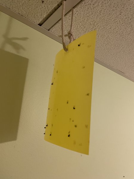

    Those flies were coming thru all the p traps and even the toilet and filled the sticky fly papers we hung up! When we came back after a few days of vacation the fly papers were loaded with those nasty buggers!!
    No other issues with the pipes except that sag!
    No breaks no leaks, nothing!!

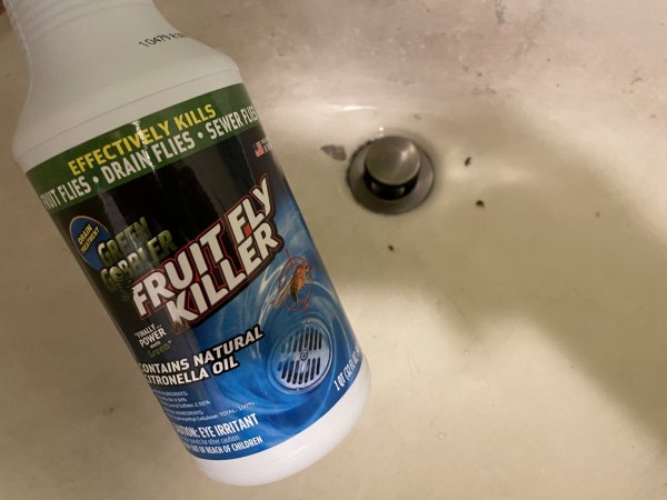

    The old copper vent stack for the toilets were replaced with PVC all the way up through the roof a few years ago. I have seen with my own eyes those flies coming out of the sink drain, washer drain and toilet just before using it!!
    Just got some of those nasty buggers coming out of the sink drain with the fruit & drain flu killer that I poured down an hour ago. :)
    Maybe the pipe fix is helping??

    I tried a lot of baking soda and vinegar but it harden and blocked up the drain like I have never seen in my life! I had to purchase an industrial drain snake and it took 3 evenings to free up the blockage from the kitchen sink! I am done with that! The fruit fly killer for $12 at Home Depot works better than anything else I have tried!
    Also the morning after the pipe fix, that horrible moldy mildew smell is completely gone so fixing the sagging pipe filled with dirty water did something!

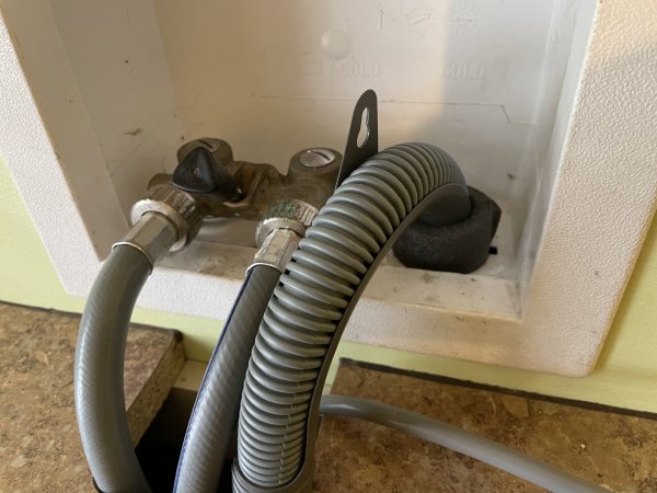

    We do have a p trap on the washer drain, it was put in new a few years ago but even the old one had a p trap too!
    I am also looking into the Fernco washer drain connectors like this one to seal the trap and our Lowes did not have any in stock, but really do not think it will help. :-(
    Fernco 2-in x 1.89-in dia Flexible Donut PVC Fitting in the PVC Fittings department at Lowes.com

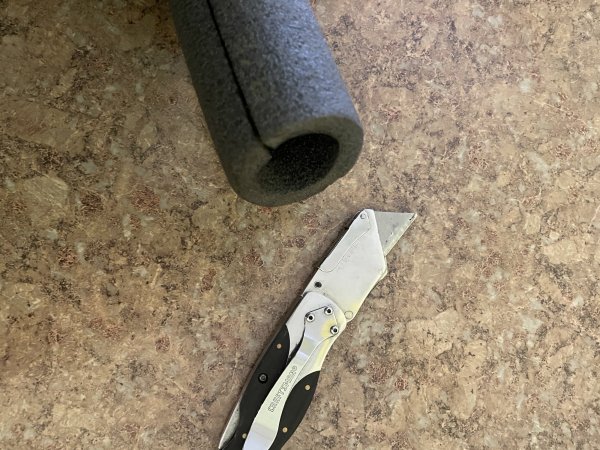

    Good Idea on the piece of foam, like a piece of pipe insulation! Thanks

    I just found a piece of pipe foam insulation from Home Depot with a 1” inside diameter that blocks the washer drain perfectly.

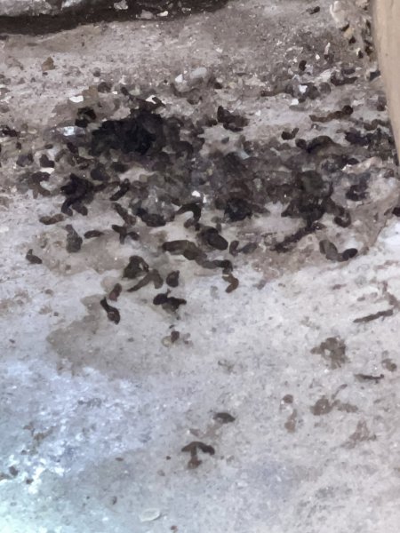

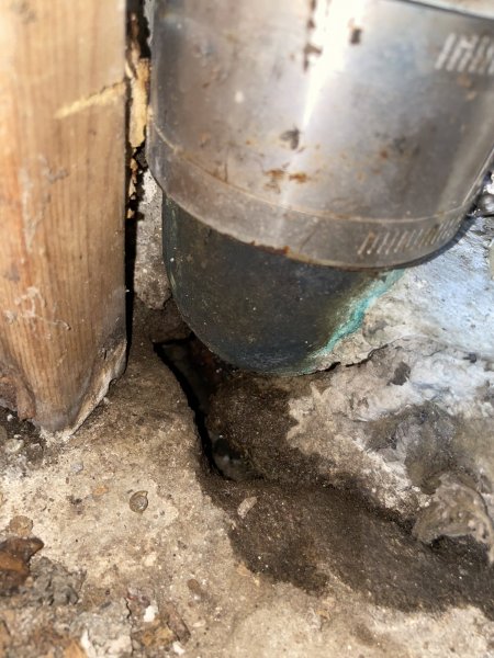

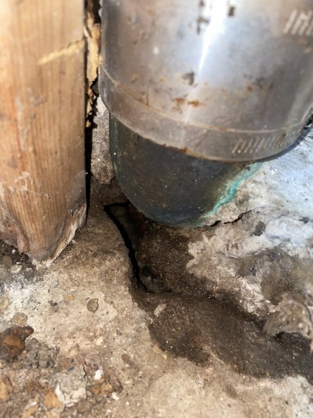

    Hi
    I just found something?
    Where the main drain goes into the basement floor, there is a drain fly?? The front side of this 4” pipe looks pretty good but look at the back side!! What is going on? Looks damp?
    How can it be fixed?
