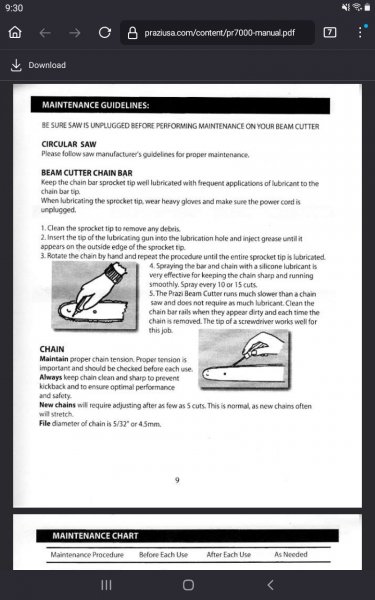

    x2, plus where is the oiler? Chain won't last long.

    That was my thought when I first saw it. And the lack of chain lube. :yes:

    How does the chain get oiled?

    Years ago I used a similar setup for cutting huge glulam beams. We had a coffee can half full of 30 weight oil that we dipped the bar in between cuts. worked fine. We also had a 16" circular beam saw that we used on the purlins.
