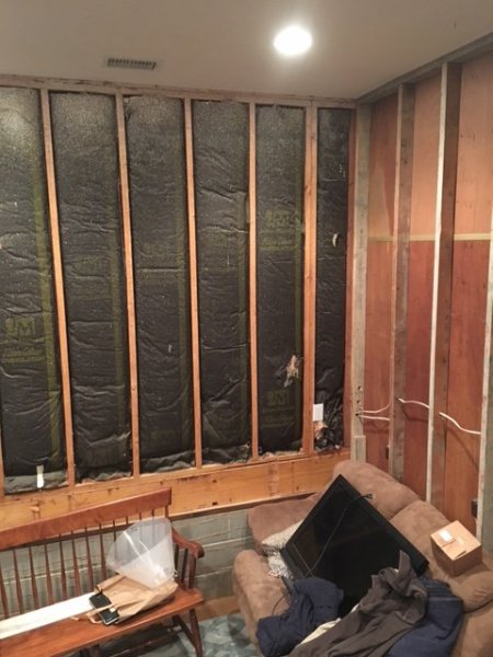

    Heres a few shots of the insulation thats in now some of it is in good shape some is torn and some is just not there. I figured since the walls are open why not put in new insulation especially since I have no idea how lod this stuff is. Is R19 good for an exterior wall? I cant find anything higher that is made to be used in walls.

    mattjm1017 r - 19, is standard 5.5" stuff, designed to fit in 2 by 6 construction.. . it is to building code..
    A couple of questions.. why are you replacing insulation? was the room cold?
    what is budget? First instinct if budget is tight.. would be add new pink were torn or missing and put some iso- board over that bare concrete block.. Concrete has next to zero insulating value... or is there blue board on outside..
    Want to help but replacing old pink with same amount of new pink isn't going to impress you with results..

    From those pics, adding isn't an option unless you go with a pink board (extruded poly) over the studs and before drywall. But that messes with the windows jambs, etc.
    Is that material fiberglass inside?
    If so, Canadian border VT makes some good points about whether it's worth it to replace. Obviously the vapor barrier has been compromised.
    You can get a high performance batt that improves it, but for a 2x4 wall you only go from a r11 to r13 or r15. Pretty minimum gain for the investment.
    Money is no object, then go new. Budget an issue replace whats bad. Assuming it is fiberglass that is.

    Oh and that knee wall as was said is a big issue unless it's insulated outside. Even so furring it out and insulating it would be a nice gain for you.

    Looks like you've got some 2 x 4 framing in some of the pics above.... That should be R-13/15.
    I also notice none seems to be stapled to the "face" of the studs. Don't know if you did that or it was like that when you exposed it.
    My take on that is that the "flaps" should be stapled to the bare face of the 2 x, to provide moisture protection on that face(it will eventually stain the finish side of Sheetrock), and to keep from squashing the actual insulation between the 2 x's (a sort of pressure fit). That tucked insulation is thereby "compressed" and diminished in its capacity to fill the stud cavity with insulative "air."
    Just my $.02 mattjm1017 .

    I'm pretty sure its fiberglass its yellow and feels like fiberglass. If you look at the last two pictures on the left hand side you can see the black board I'm talking about it is all over the exterior of the house under the brick its on that wall because it used to be an exterior wall.

    That black board really does little to help insulate.

    Could you fir out for an R-19? Would be a hassle to extend jambs(not too bad tho) but you'd get some 2" more per bat in thickness.
    Combined with schlot's solid reminder about air penetration, nipping air movement and adding a thick fresh pink....blanket, that would be "the exit side of the cat!":thumbs:
