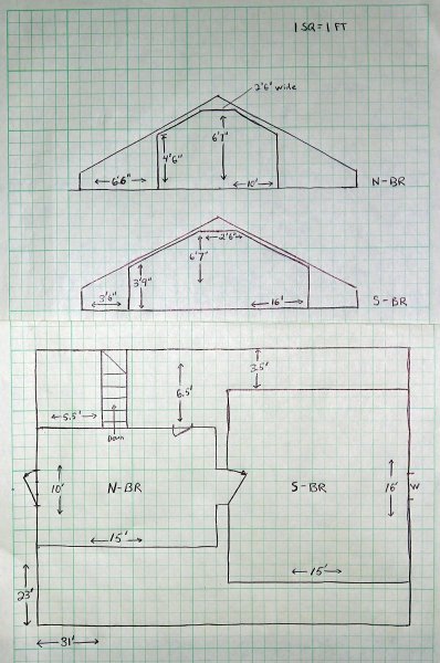

    About the house... 1900 cape cod, 32x24 with knee-walled upstairs and a short cellar underneath. Addition in 1990, 22x36 2-story with full block basement. The house is tee shaped. Probably the biggest heat loss is the upstairs of the old side. I recently found out why - one half of it has no insulation on the knee wall or ceiling. This room has old plaster and lath walls. There are fiberglass batts on the floor on the attic side of the knee wall. The other room upstairs they did renovate recently before we purchased the house. It has drywall, and they used fb batts everywhere... the floor, walls, ceiling, and even eves and roof. It was not ventilated, and they also sealed everything up with plastic sheets and it has collected moisture and some of it will need removed. Anyhow I am going to focus on the uninsulated part as it is a pass through bedroom, which includes heat... heat has to go through the uninsulated room to get to the room on the end that is my sons bedroom. And during the coldest couple months of winter it is often low 50's up there, even 40's. That't with both out pellet stove running (directly below that room) and Jotul Rockland in the new side of the house.
    Here is a sketch, to scale best I could. This is the upstairs of the old side of the house. 2 bedrooms labeled North and South (N-BR, S-BR). The S-BR was the one remodeled with studded walls and insulation, and they made it wider.
    I've got some advice recently and had a few directions I could go. Trying to add insulation to what I had, or gut it and start over. I've pretty much decided to gut it. I'll remove the plaster walls and re-stud interior walls to match the width of the other room and use drywall.

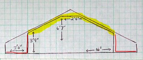

    Just for clarification here is a cross section pic:
    Red lines I plan on using FG batts, radiant barrier (at least on the vertical part) with air sealing underneath. Yellow part use vent baffles (if I decided to vent the attic) then FG, 1" foam board, then drywall. The little mini attic at the top will be where roof vent goes if I decide to vent, otherwise I'll pack as much insulation as I can up there. Right now all there is up there is FG batts on the horizontal part of the red lines. Everything else is uninsulated. I'll try to also air seal under the knee walls in the other bedroom that was more recently remodeled. I also plan on removing the stairway, as it is unused and makes the attic non-continuous. The north end of the upstairs adjoins the upstairs of the addition and that's how we go up there. I'll lose how a lot of heat comes up though, so may install some floor vents. I'll have to check local code but I've seen houses around here have them.
