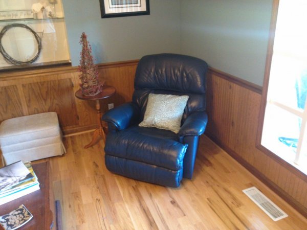

    OK so when the Englander NC30 goes on sale this spring I am gonna grab one. I have the spot picked out for it. It will be a chimney straight up through the ceiling and roof.
    Any body got the clearance to combustibles handy? And what about the clearances below the stove? And if I use a steel plate how much does it reduce it?
    Also the through the ceiling connection, my roof is pretty close to the ceiling in that spot, not like 12"s close but maybe 3 feet or less from the finished ceiling will this cause any problems?
    Here is where the stove will go. Thoughts on how to constrict a hearth?
    Cement board over flooring to a certain thickness then my stone over it? And then how far up the walls do you have to go? To ceiling? The stove will be right where the ugly blue chair is facing out at a 45 degree angle from the corner.

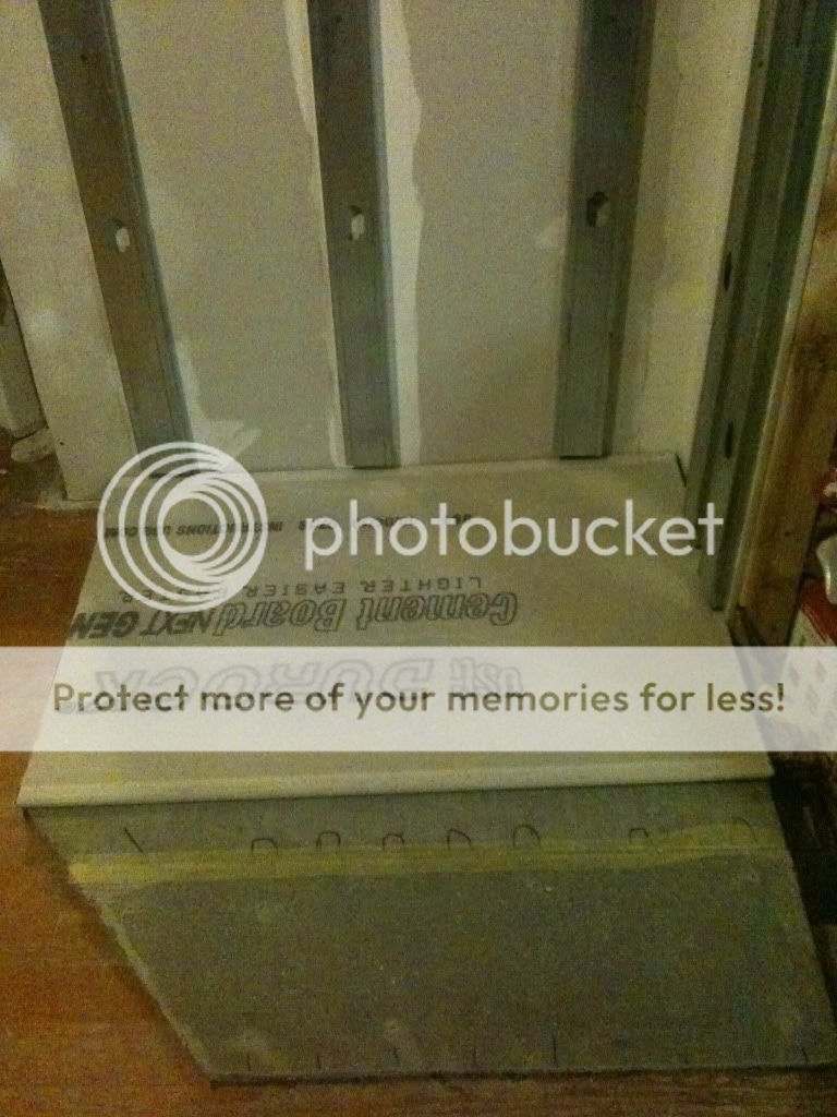

    I've got mine in a corner kinda of like what your looking at. The side throws quite a bit of heat out. I'm at or just about the requirements. I usually throw a fan on my tile just because I get paranoid. When I can radar about 160 to 180 on the wall tiles. I've got a 1 inch spaced steel 2x4 & concrete tile in there. It's opened on the bottom and top for air insulation before the Sheetrock.
    The base is steel 2x4 with 2 layers of Durorock and 1 layer concrete, then tile on it. Which it stay nice, just the walls that I worry about. I'm thinking about getting the side shield to help with the radiant heat throw that you get from it.

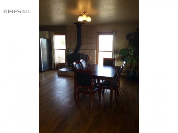

    Years ago in Colorado the safety specs called for cement board with non combustible material on top. He used 2" x 6" to build platform frame, then cement board, then ceramic tile. I think the thinset or balsa/luan is is needed in homes that might be settling or older & shifting to prevent the tile grout from cracking. He screwed our platform into the subfloor for stability, not portable. He also built another frame on the backwall behind the stove for extra protection, protected it with cement board, and we tiled that too. Not SC codes but he researches well and always errs on the side of caution. I also bought a large platform for a woodstove at a local hardware store that went out of business to practice tapdancing at that time, it was absolutely portable, about 4' x 6', similar framing, finished hardwood over cement board and certified for woodstove base. Tile has since went out of style but I had confidence it was safe. 726382_8_0.jpg

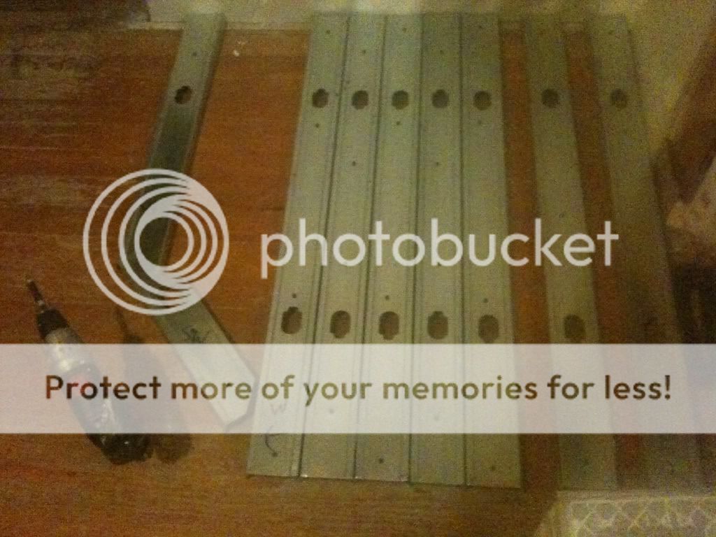

    After looking at pictures it looks like it was the 1 layer of Durock and 1 layer of Concrete board, so I misspoke. But everything is screwed down to each other. After the Durock was set, I then thin set it for the tile. But in the first picture you will see basically where the stove will set. Those 2x4's are screw together for the weight of the stove. Remember this is only one way of achieving the end result, always error on safety. Good luck...
    Base: I did screw it down, did want them to move with all that weight on them.
    Heres a picture of the base and wall. The 2x4 steel studs have a 1" air space on the bottom to support air flow and that insulation value.
