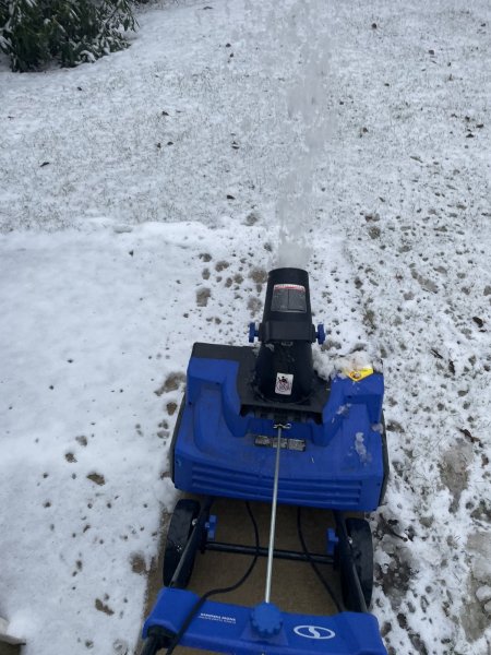

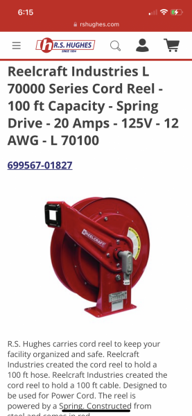

    In my case, the new Snow Joe electric snow blower for the walkway should have a heavy duty extension cord and a 20 AMP 100 Feet retractable Reel Craft cord reel seems like the way to go?
    I ordered up the ReelCraft L 70100 123 3A 12/3 AC cord reel.

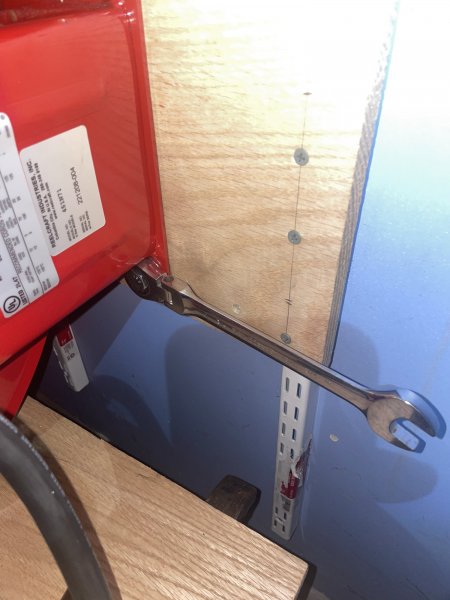

    It weighs 74 lbs so having an Escalara Stair Cat or any fork lift to hold it in place on the wall makes it a little easier to mark the holes for mounting. :)

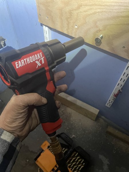

    I picked up some strong solid OAK shelving boards at Home Depot custom cut to bridge the studs in the wall for a secure mounting with 1/2” diameter Lag bolts with 3/4” hex heads and Stainless Steel flat washers and lock washers!

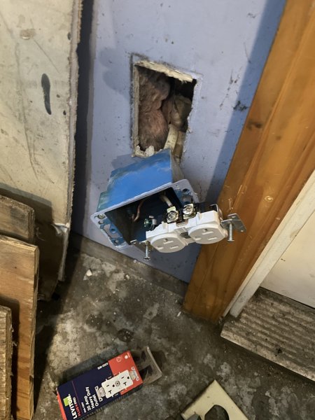

    Also picked up a 20 Amp extension cord to reach the wall outlet. The wall outlet has a 20 Amp outlet with 12 Guage wire to the circuit panel with a 20 AMP circuit breaker!
    So should work for the electric snow blower, car vac and any other electrical need?

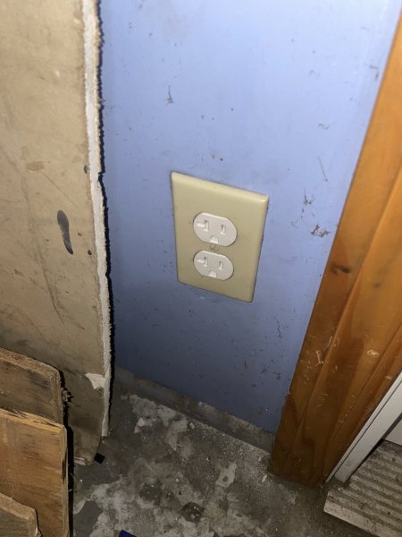

    I already have the 20 amp breaking in and the 12 Guage wire so I just got the 20 Amp outlet for the special 20 AMP plug. See horizontal slot on left side of both outlets?
    Any comments? See pics below

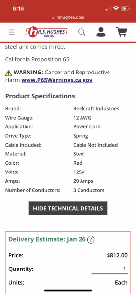

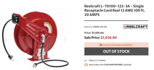

    Pic 1 - First price I saw
    Pic 2 & 3 - Zoro with my 20% coupon was the best price!

    Pic 6-10 - bolting it into the solid AOK board mounted to the wall studs

    Pic 13 - 20 AMP circuit breaker
    Pic 14 - 20 AMP heavy duty outlet.

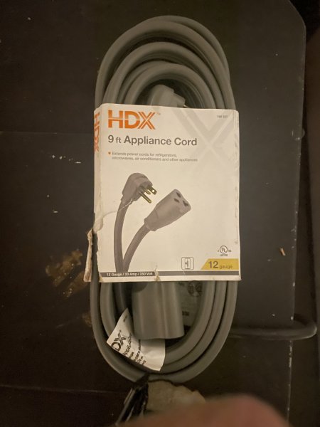

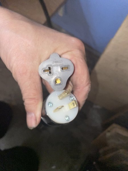

    Got the NEMA 5-20R duplex outlet in the wall and all wiring to this outlet is 12 Guage. A little tougher to work with than 14 Guage. Then tried to plug the cord reel in to the extension and the extension cord into wall! Turns out the only extension cord that looked like what I wanted that Lowes and Home Depot sell is the 9 ft appliance cord made for 220 volt air conditioners that have the NEMA 6-20 plug & receptacle on it! However the flat prong on the right side above the ground pin and I need the 120 volt AC extension cord with the flat prong on the left side above the ground!! See last pic below
    Does anyone know where I can buy a 20 AMP 120 volt AC 6 ft extension cord with a NEMA 5-20 plug & receptacle on it locally? I only see them on the internet?
