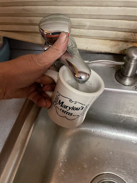

    Pic 10 - Instant hot water is Back! It works!

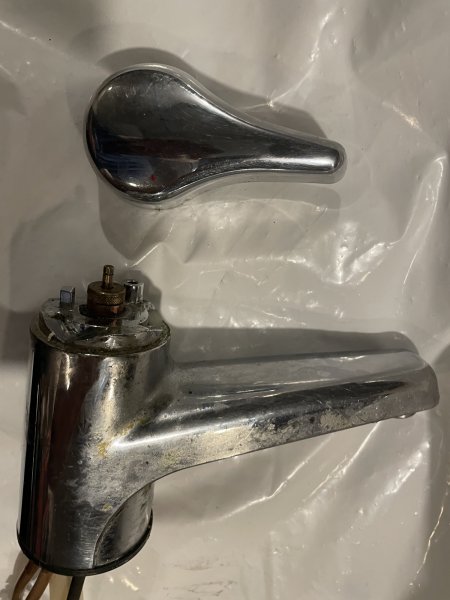

    The Broken Piece with top broken off
