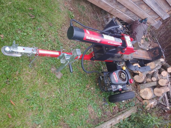

    My dad bought this a number of years ago. The engine code says it was made in 2004. Our first hydro splitter.

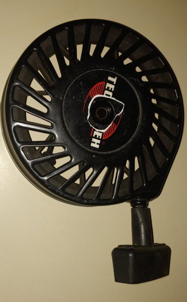

    MTD 21 ton splitter. It has a Tecumseh 5hp vertical shaft engine on it. Never had an issue with it myself, but mom used this and there was a Jerry rigged recoil handle on it. Part of a ratchet strap tied to the recoil rope. That worked until the "knot" let go and the recoil rope retracted all the way into the housing. So I had to pull the recoil assembly off to try to fix it.
    35 minutes of screwing around with the recoil rope and I got it. I had to use a tiny eyeglass screwdriver, some floral wire, a needle nose pliers, a tweezers, and Scotch tape. I used an old pull handle from a push mower that died years ago. The rope was fine.
    Done.
    I'll put the recoil back on and see if the float needle valve is working as it's supposed to. The engine smelled like fuel after hauling it home 200 miles, and the fuel tank was empty. I'll probably pull the carb bowl and clean the fuel tank out for good measure. I have a little ash I need to split to test it out.
    If I need to dig into the carb and swap the needle valve, I will.

    I don't think I used yours Dennis. This one has the auto return valve. I could've sworn that this one was older than it was, but I looked up the engine date and it can't be older than that.
    The "arms" that holds splits are all bent up, as they were not very HD. That's won't matter once I make this into a trailer splitter.
    There's no fuel shutoff on this one, yet. Adding one is super simple on this engine. Also, I bet the fuel went into the engine. It will get an oil change brenndatomu . It needs that anyway, but I think I know where the fuel went.
    The fuel tank is tiny, I'll probably want to add a bigger tank at some point. I'll recycle a tank from something else.
    I'm not certain how the pump is run. I'll take a look if it's belt driven or direct drive.

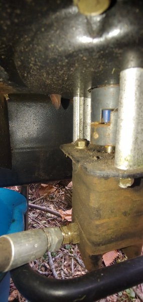

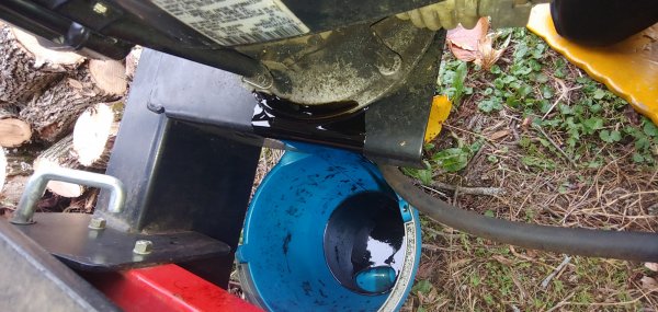

    It's Lovejoy direct drive. And yes. Oil level was high and smelled like gas.
    Draining oil. At least there's a plug.

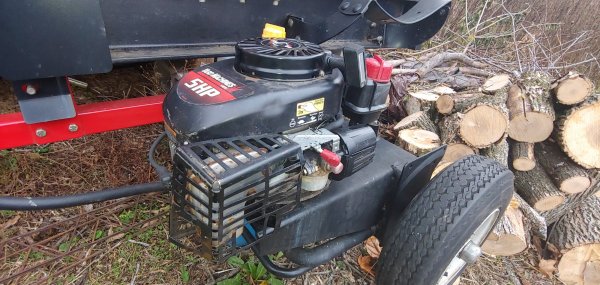

    Recoil assembly on

    Changed the oil, it needed it.
    It has spark, so that's good.

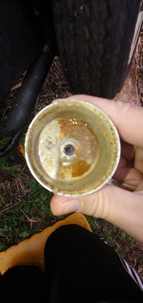

    Here's what was in the carb bowl.
    But it won't pop over. It's fuel delivery related.

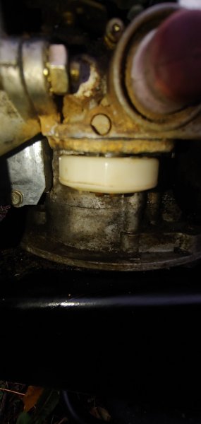

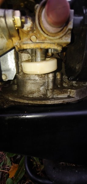

    The carb at worst needs cleaning, the float doesn't swing easily and will stay hung up, or down, wherever you put it, even defying gravity. Not good.
    Down
    And up??
    I'll see if the carb cleans up. If not, a new carb is like $14 online.
