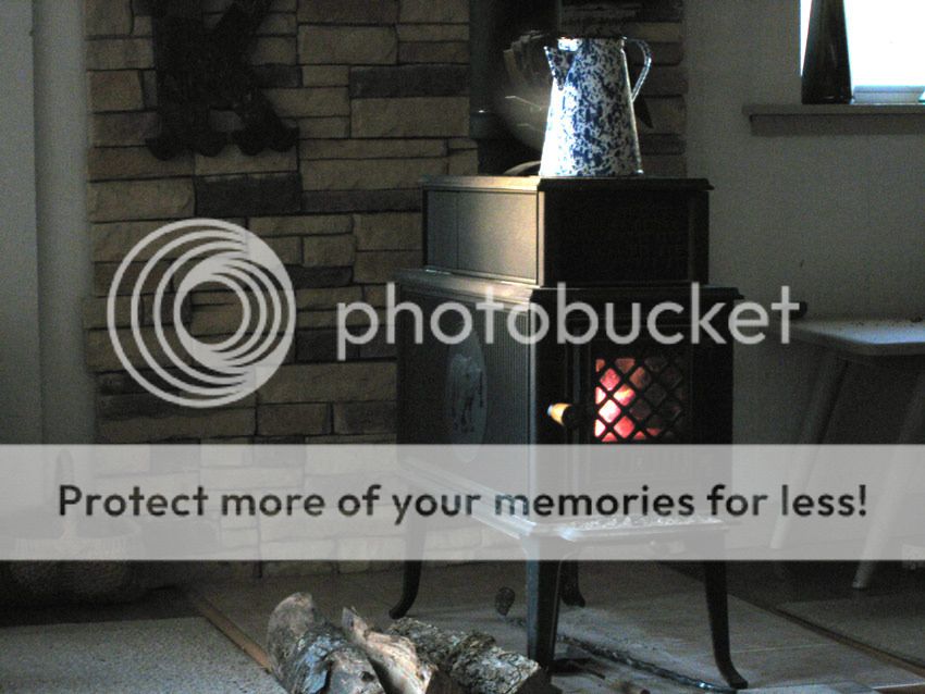

    8 years ago we replaced a Vermont Casting with a Jotul 118CB & love it!. Bought a Jotul 602CB for our son's cabin last month. Wanted cast iron, quality and no cat... We found our brand of stove!

    Nice looking stove with deep firebox. How big is the firebox and what kind of burn times are you getting with it?

    1.47 ft box, up to 24" wood. 5-6 hours of burn time, with good coals at 8-9 hours.
    It's really too much stove for our 1200 sq foot house, but Nice when temps are in the single digs.

    Hard to beat that Jotul 118CB as a heater and a stove. A true "classic" and functional stove.
