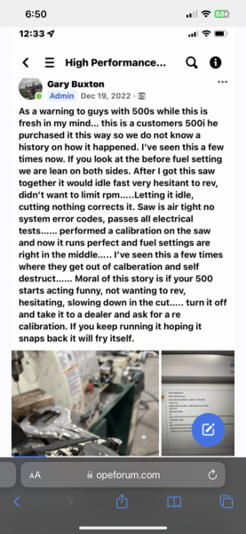

    7BA10E56-92C6-4049-88C6-8DEC74378079.png Fwiw I recently read about fueling issues with the 500i. Buxton work saws brought the issue to light.

    If the goal is to put the saw to work feeding the LT-15, for profit, then it will need to be maintained as such. A conversation with the dealer on how they prioritize commercial units/customers, meaning machines that must run to put food on the table, can save a lot of regret and heartache down the line. Especially with equipment that may have systems you cannot/do not want to maintain yourself. Doesn't matter if it's a weed-wacker, or a million-dollar excavator. There is no machine that runs day-in and day-out without some kind of support/maintenance.
    I'd lean towards the 500i, for heavy use, as long as you are confident in the dealer's ability to support it should an issue arise.

    The 462 you were looking at may or may not have been mtronic. They’re available both ways but the mtron models are scarce in the last year due to wiring harness shortages. The electronics on both the 462c and 500 aren’t what I’d call “failure prone”, but there are certain instances

    Just shopped around again today kicking them both . They both feel amazing . 500 is a bit bigger body maybe .5lb heavier . Thanks for bringing the possible mechanical issues to light . That helps . But I don’t think either one might be prone to never having issues
