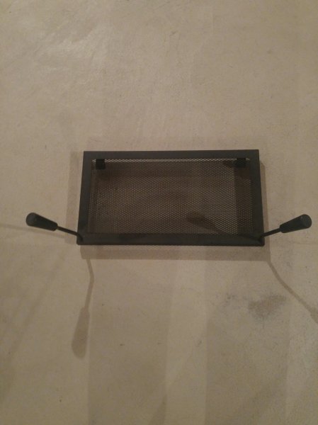

    This screen came with my Enerzone. I've used it 3 times in the last 4 years. Usually on Christmas day.
