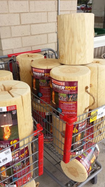

    Had to stop at the grocery store today, on the way in I spotted these...
    Swedish candles, just $14.99 each... plus tax! I get that they are peeled logs, with a nice little rope handle... but really, rough guess that would be $1200 per cord... for pine!
    The guy that processes my father in laws wood says he sells 9= 3inx3inx16in sticks of fire wood for $6.00 each, roughly $720.00 per cord.

    Looks like they made a more or less standard Swedish candle after using a large diameter bit to bore a hole in the center of the log. Normally a Swedish candle is just 3 or 4 chainsaw kerfs cut down maybe 3/4 of the way in a round and all meeting in the center. By starting with a larger center hole you just make it a bit easier to light. If you had a hole the right size a wax and dryer lint Girl Scout fire starter would work great to get it going.

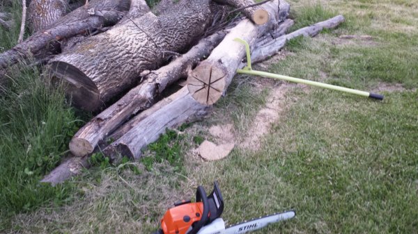

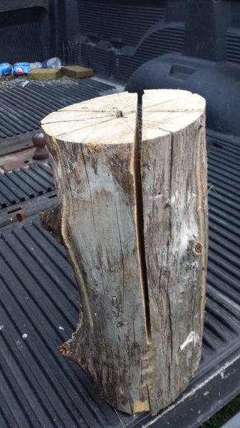

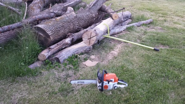

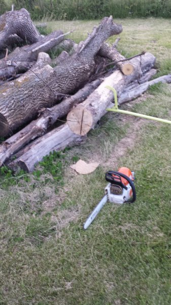

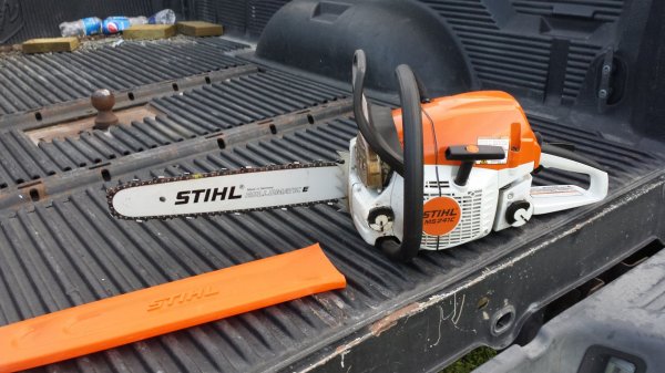

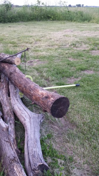

    Here ya go Horkn
    Step one get a saw...
    Step two, pick a log 8-12" diameter...
    Step 3,4, and 5- noodle 3 times...
    Step 6 lop it off 6" below saw kerfs...
    Wala Swedish candle, and as always use ppe and have camera/ cell phone.
    I just did this one in 10 minutes or so.
    And that, is the rest of the story.

    Thanks for the tutorial FarmHand78 !
    It's almost too easy.
    I'll have to make one this summer.
    I'll use a chunk of dead standing elm. That way I won't need to split it!;):thumbs:

    This one was from some silver maple I cut down 2-3 years ago, should be good and dry from the way it was splitting.

    Actually a clever idea. I like the way they have that fire starter strip hidden in a hole behind the label. Although a hidden bag of marshmallows might be a better idea???
