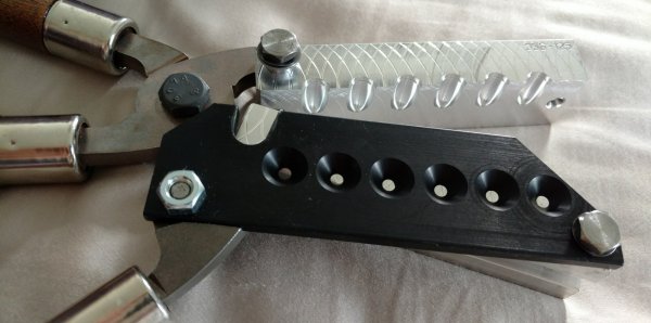

    Lee 6 cavity mold:

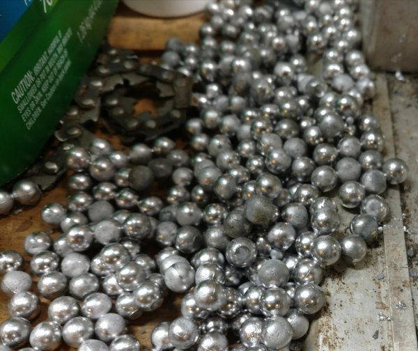

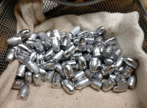

    Tonight we, my son and I, casted up 500+ 124 gr 9mm. I'll give powder coating a shot, for the first time, tomorrow.
    Here's a pic part way through the casting session.
    Here's some hard cast 00 Buck. Since it's hard, it doesn't deform as much as standard store bought buck. It doesn't fly as well as Federal's Flite control wads, but it does pretty well and is way cheaper. These come out of the mold in a string of three and need trimmed. I guess I could have done a better job staging the chain, I had to crop the pic to meet size requirements.
