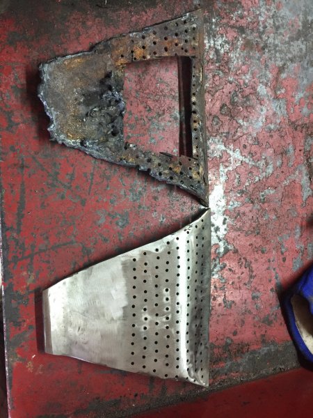

    I hauled the burn pot out of the furnace, the top burn pot was in rough shape. So I cut it out with the plasma and going to make a stainless one instead. From pictures on the Internet, it seems the burn pot is rusting out from ash, not really burning out. I'll take a picture and show ya. There was no igniter in the burn pot when I got it. Actually that's what the yellow wire is for that I fixed. And the yellow wire cycles on when it calls to ignite.

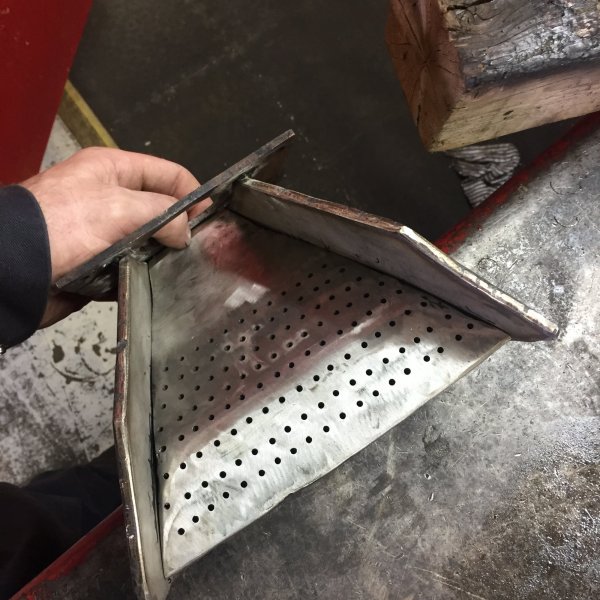

    I think it will work. Better than the old one. Lol I was careful to drill the same amount of holes, with the same spacing, and of course the same size holes. Think it’ll work?

    I hope you're using stainless steel:whistle:
    Got to pat you on the back for taking on a job like that:yes:
    The old burnpot was toast:bug:

    Yes, the two sides and burn plate with the holes are stainless.

    If everything is the same dimensions as OE, no reason why it shouldn't. Nice work fabbing that up.

    yea, I think it will. Harman found out it needed to be stainless steel the hard way, but this should work, even if it isnt.....just watch the pot, and replace again if needed. Also, that backplate LOOKS warped....might want to double gasket that thing......I could be wrong on the warp though...the warp in the pic looks to be on the first knuckle of your thumb....throw a straightedge on that and see it it is straight.

    Looks warped right there to me too.

    Yep, it’s bent just a little there. Think I might have bent it in the vise when I cut the old plate out. Small job, I’ll straighten her out.!!!! Can’t wait to try this pellet monster!!!!!
