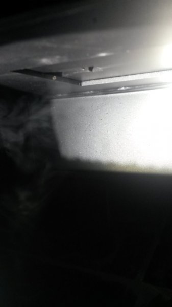

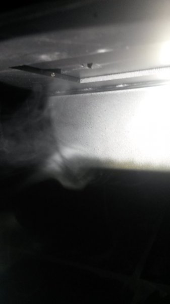

    Hello all,
    I decided that rather than clutter up the Ideal Steel pooping thread, I would post my own thread describing what I found.

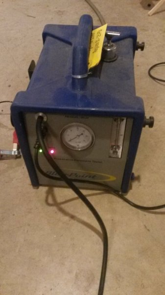

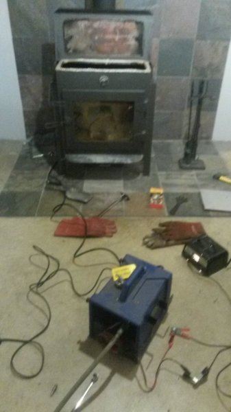

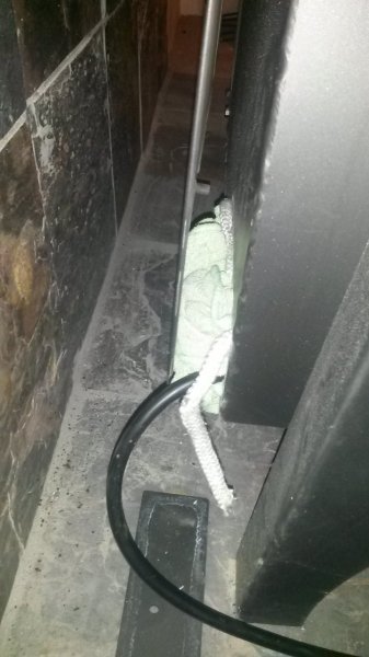

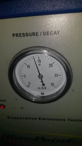

    I am using a Blue Point evaporative emissions smoke tester. I removed the rear plate at the location of pooping creosote and put the hose in there with rags to close it off.

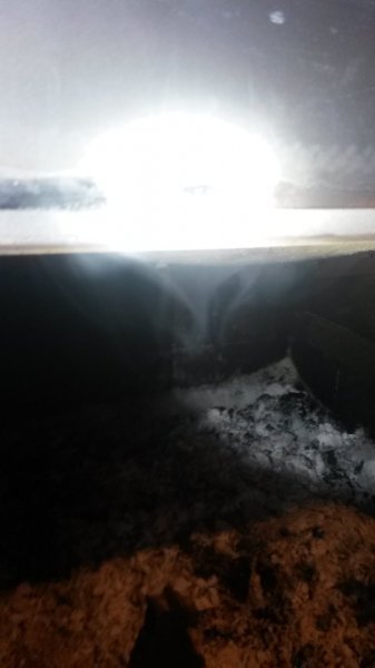

    After pressuring the cavity, I found smoke exiting the rear stove intake bottom hole (secondary air intake?) . I then closed this hole off with a rag and smoke started coming out of the holes in the secondary burn plate at the top of the firebox.
    In my mind the mystery is solved. Creosote has formed in the secondary pipe/ channels and worked its way into the cavity where the leak has formed. I hope this helps. Just for the record I have not had the creosote issue, I'm just investigating.

    This tool is used in an automotive shop to find an emissions system leak. It is more of a specialized tool but most shops have them. I doubt they will rent it to you.

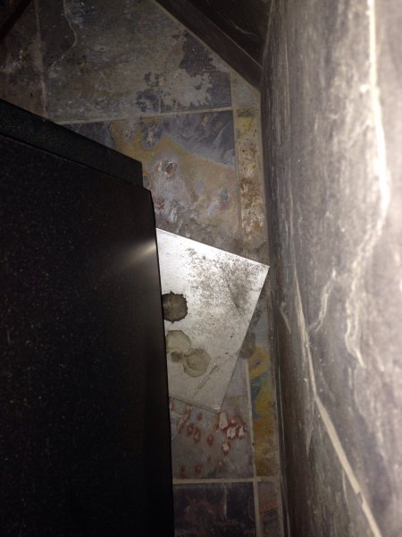

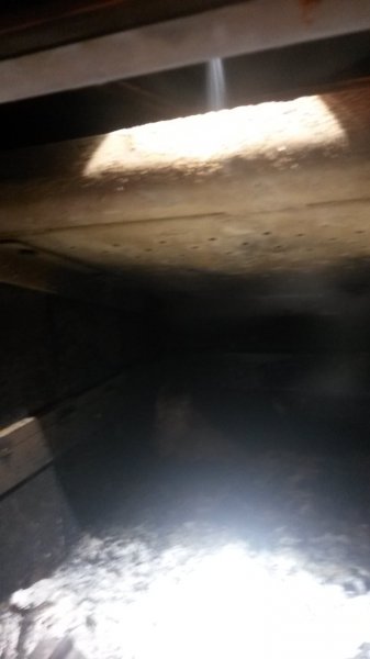

    This pic was taken looking down the back from the top. After reading this thread I went to take a look. There's a 3" black drip on top of the ash pan lid that's stored under the stove

    Wow, it looks like there are two stoves out there doing this and maybe more.

    The photo looks like three different drips.... ?
    Can you tell (by the original placement of the ash pan cover) where on the stove this stuff is leaking from?
