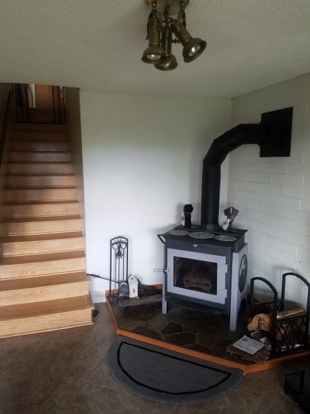

    My Ideal Steel is in our basement too. It is a walkout or daylight basement so the back of the house is exposed and finished with stick building (with insulation in the framing) but the other 3 sides are brick. The previous owners just painted the brick and never insulated the brick walls so I think I'm loosing a good amount of heat through the walls. I want to insulate these walls and will but my stove sits in one of the corners and I don't want to pull it away from the brick any further as the horizontal run through the brick wall is already 12 to 16" before the chimney goes up on the exterior of the house. Should I leave the stove 7" from the brick and build a none combustible wall between the brick and stove? or move it away 5 more inches and insulate the wall with framing and such... Things that roll around in my head and keep me awake. 20190915_090519.jpg
