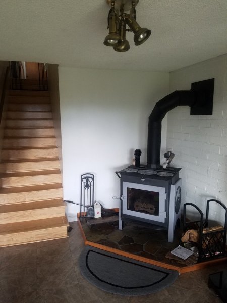

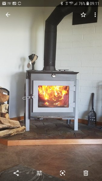

    fmelani, For a brief moment I thought you were describing my house. We live in Western Nevada at the eastern base of the Sierra Nevada Mountains. We get a good amount of winter storms that come through our area and I was in the same predicament as you.
    We bought our house five years ago and I really wanted to supplement with wood heat from a woodstove. I researched both Blaze King and Woodstock, as the county I live in only allows woodstove installations of units that have an EPA rating of 1.0 GM per hour or less....
    So at that time there were really on 3 stoves to look at. The new Ideal Steel, The Blaze Kings, and the Lopi Cape Cod.
    The Blaze King Sorroco and Ashford were contenders but the local dealer was an A$$ and I didn't want to give him any business. The Cap Cod was too pricey form me too.
    So I focused on the Ideal Steel.
    My house's layout is near identical to your house. We have a 2300 square foot ranch 2 story home with a daylight basement. The only place I could put a stove was in the daylight basement.
    I ordered my stove through Woodstock and the whole stove with shipping (2,400 miles mind you) was around $2700 total.
    If I went with either of the other stoves I'd be looking at double that with taxes...
    Anyway, I installed the stove just as you mentioned, through our uninsulated block walls and up the side of the house. 22 feet up.
    The stove sits right next to the staircase and I'm able to heat the whole house with it. The kids bedrooms which are upstairs and all the way on the opposite side of the house will still be 70-72 during the dead of winter with the stove going.
    I think you cant go wrong with the Ideal Steel, plus their customer service is second to none.
