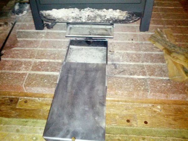

    I can't imagine a stove without it. I have the ashpan on my beta. Works good. I am not sure what the final version will be like, but mine has a cover that you can slide over the pan, while it's still in the stove, to keep the ash down. As for the seal, the latch is works great. I can take pics tonight if you like? Anything you want to see?

    Not that anyone asked but here are some pics. I had actually slid the cover on the pan while it was still in the stove. I just slid it off again for the pic.

    Thanks for the pics Death and Taxes. You posted them before I could ask for them!
