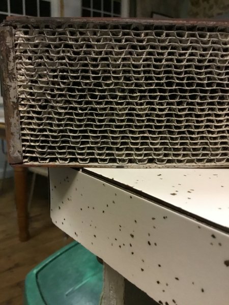

    About how many months, days, or hours do you guys run between cat bath cleanings? Talking vinegar/water spray and tap water rinse. What ratio should I be using and how long to let it sit before rinse? And then how long before reinstalling into a warm stove? Plannning on pulling it before a relpad when burning down coals.
    I've vaccumed/blown it out a few times, started burning 24/7 end of last January (20th or so) till mid April. And now for about a week this year.
    Thinking I should be cleaning it about now? Still getting good temps 1000-1200 but not shooting up as fast as when it was new. More of a slow gradual climb when I close it at 550-600. And step down to final setting every 3 mins or so. Doesn't seem to be holding temp up after a full load burn like it used to when new. I would find it still in or close to active temps in the morning. Now its closer to 300-400. That could be due to different wood mix though I guess and different air settings compared to last year?

    Bath; once per year is plenty. I never use tap water though; distilled only. 50/50. You can rinse right away. Let it completely dry before using, but if you do the bath in summer, no need to be concerned with timing.

    I find that the less seasoned the wood is, the more often you need the wash the cat.
    If your not getting good hot/long burns, go ahead and clean it. But plan to dry your wood longer. If your on the 3 year plan, step up to 4.

    I usually clean mine twice a season, sometimes three times if it is getting sluggish.
    I do the vinegar and water thing; I used to soak it but now just rinse the combustor thoroughly in the sink, then spray it down well, from both sides, with vinegar and let it sit a few minutes (maybe 10). Then another good rinse (we have excellent water here, very soft so no mineral content to speak of) followed by a good, hard shaking to drive off as much of the water as possible. Then back into a warm stove (the stove is always going when it is cold out), and by the time the firebox is filled and engaged, I am quite sure all the water has been driven off so I just close the bypass as usual. Even if there is some residual water in the combustor, I cannot see how it could do any harm and it will NOT be there long in a 500- 800F stream of wood smoke.
    Just my opinion and I certainly do not know but I do not really think you could over- clean a cat. I do not believe such a mild acid as vinegar will hurt them, so you could clean it once a week if desired. And certainly they can be under- cleaned; some people never clean a combustor and I believe they are missing out on a substantial amount of combustor performance and efficiency because of it.
    BTW: cleaning a cat. usually helps it recover somewhat but it certainly will not recover a cat. with a lot of hours to like- new condition. They deteriorate with age and so I think a reasonable expectation is that having a cat. that is running at 50% as well as it did when new and cleaning it may return it to 60% or maybe even 75% but not 100% if there is much time on the cat.
