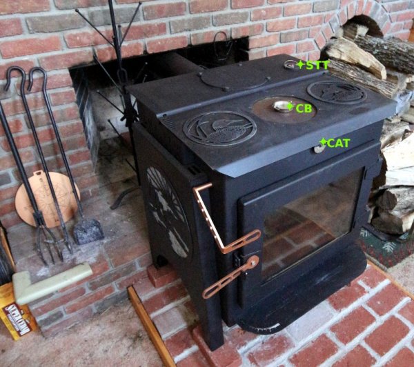

    Oh and before I forget here are the thermometer locations I will be referencing:
    Using a Condar catalyst probe, grill surface thermometer on the center burner (hottest part of the stovetop), and the Woodstock supplied magnetic thermometer on the back corner of the stovetop (kind of average STT).

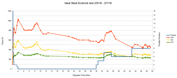

    And here are the stats, 22 hours into the burn so far...
    She burned just a tad hotter than I wanted there in the first 12 hours, but I think I'll still get plenty good long burn. My house is not very insulated and drafty so by itself this wouldn't be feasible right now (low in 20's high in 30's) but with my pellet stove running on the old side of my house (it's on its minimum setting of 1) is about perfect.
    I'm also trying to see what it does with minimal amount of fuss... shut it down in 3 moves at the beginning, and then 2 more at an hour and a half (should have just done those in one). It has been fully closed (first notch) ever since. I'll probably bump up the air once it gets close to 500 CAT but so far the house is warm and I am letting it coast as much as possible.

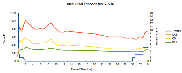

    Just hit the 34 hour mark and still looking good. Should burn through till the morning I hope.
    It was tapering off though, which worked fine for the bright sunny mild afternoon we were having. But with nightfall approaching I decided to bump it up. She wasn't throwing out a ton of heat, but still keeping that side of the house a degree or two above what I really needed so no complaints here. But wanted to get it up a tad for night... at 30 hours I bumped up the air 1 notch. Temps still slid a bit. 30 minutes later I went another notch. Temps picked up a little but within about 30 more minutes they started to decline slightly. I wanted to see if I could get it up a good 100F hotter or so, so at about 31 hours into the burn I decided to open the door, snap a pic, and stir up the fuel a bit.

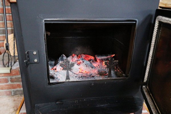

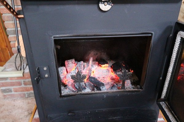

    First time opening the door, 31 hours in. The back row is still just about full sized.
    I toppled the stack, poked it a little, closed the door and turned the air up a bit more. Now on notch 5. In one hour on notch 5 the CAT went from 575-750 and center burner 295-345.
    Here is the graph updated for 34 hours:

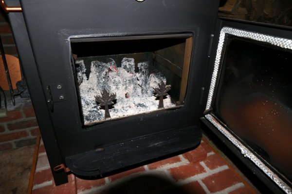

    Its still alive... barely. Here is a pic when I work up around 6 am... 42 hours and 40 minutes
    I stirred it up again and opened the air a couple notches. Some of those bricks on the bottom were quite solid still!
    At 300F on the center burner right now. I won't let it get to the point of needing paper or tinder, but going to try for 48 hrs...

    And the chart plotting all the temperature points I recorded:
    Realize there are some big gaps between points when I was outside or sleeping, etc.
    I am very happy with the results! I was able to shut it down fairly quickly, but still needed 2 hours to get it into long stable burn. I could probably have shortened that some, and one or two less moves. From that point it ran about 28 hours completely untouched, and could have went much longer but I didn't want the CAT to get too close to 500. And it did not dip below 500 until about 40 hours.
