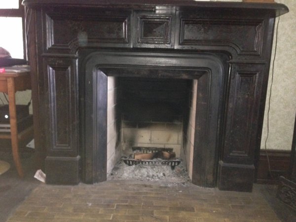

    Hi, after researching we think an Ideal Steel would suit our purposes. However, we are concerned about clearances. I've looked at the Woodstock site and put in an email and catalogue request, but would like additional input. We REALLY REALLY want an ash pan but I'm not sure it will fit. The stove will sit in front of the current fireplace, which has a 28 1/2" height opening. The surround is all metal. There is a shallow tiled hearth. We would like to rear vent and attach to a steel liner in the chimney.Does The ID steel come front the factory with adjustable legs or are they fixed in height at ordering? How will heat shields affect clearances and fit? Here is a pic of where we are planning to put the stove. Thank you for your help. image.jpg

    I'm not near my stove to take measurements but- the legs are adjustable, just not easily adjustable. That's why they ask for the height you need and set it up for you. Especially with the ash pan, you need a way to hold it up without crushing the bottom. Without the ash pan I would probably just use a floor jack.
    I've had both and I would totally recommend the ash pan if you can swing it.
    The rear heat shield sit near flush with the top lip in back so it doesn't get in the way.
    Can you extend the non combustible floor and sit the entire stove outside the fireplace? The biggest clearances for the IS are the front floor and sides.

    We are planning to set the stove outside the fireplace. The tiles hearth is only 19 1/2" deep, so we probable have set the stove on a hearth pad, thus reducing the height we have available. Not being able to get the ash pan would be disheartening.

    I am not sure I understand, if stove sits in front of the hearth and is rear vented the rear vent even with tallest legs is less than 28.. but I will put another vote for just call woodstock. tell them what you got and they will tell you what will work...

    According to the website Flue Height to Center (Max Leg Height): 29.5"
    And that's to the center... so assuming its 6" pipe than add at least 3" to it, 32.5" tall. Min height 24.5" (+3" = 27.5") so will BARELY fit with single wall pipe if there isn't much rise in the pipe and the stove isn't raised any higher than the existing floor (is the floor r-value atleast .41?). Not sure if the ash pan changes how low it can go.
