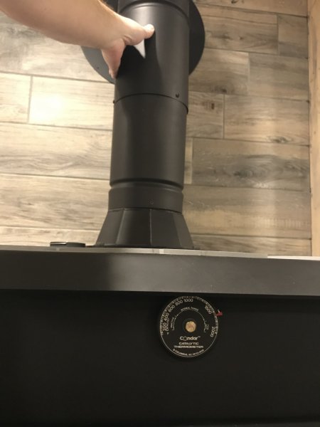

    I'm sure this has been hit on a lot before but I haven't found the answer. New IS installed and I've gone through the break in fires. I'm not burning a lot because I don't have a lot of seasoned wood. I'm using some of my 2-3 year old splits that were leftover from the move. I also had an in store credit at menards so I decided to buy 20 packs of eco bricks, or whatever the brand is. Here's the situation, I can easily get the cat probe up to 500-700 degrees and engage the cat. Once I do, I choke the air down and settled the burn down. The black box usually happens, even with the bricks, and the cat temps climb. With the air about 2-4 small notches open, almost shut down all the way, the cat temps will easily climb to 17000-1800 degrees. Stove top, left of the collar, will be 400-450. That's good heat, but there is no way I could open it up more without the cat going much higher. I'm okay with this, except I'd like to get a little more heat from the stove. I'm waiting on the cat to "break in" a little so it's not so hyper active. Will the cat temps in the 17-1800 range hurt it? I've been trying to keep them around 1000-1200. I can rest my hand on the double wall at these temps without any problem at all.

    I have been mixing in some ash that I have. The cat probe just goes straight to lava when I load the stove. I just loaded the stove again after a 25 hour burn. This load had 3 good ash splits and 12 bricks. Lit off on a coal bed. Secondaries came on fast. Got the typical dancing slow flames and oxy/acetylene torch flames from the secondary plate above the load. I let it get going well, started to choke it down to half, engaged cat and it ramped right up...way up. Probe was almost maxed 1900-2000 degrees. Air choked all the way down, still had very small, lazy secondaries and the cat slowly dropped to 1500. This cat seems really active. Basically uncontrolled. I tried opening up the air to get more secondary flame, cat still stayed high. At one point I opened the bypass, afraid I was hurting something. I will get it figured out. These bricks are nothing to sneeze at. I'll put just a few in the next load with more ash splits. Secondaries when it was straight nuclear in the pic below. Stovetop was 525 and I could touch the double wall pipe without any worry. I'm wondering if my Condar isn't right. I'll boil some water and proof it.

    I did peak under the lid when it was cranking hot and the cat edge was barely orange. The baffle above it wasn't glowing like some pics I've seen. I'm questioning the probe a little.

    Think I found the problem. I let the probe cool to around 200 and then put it in boiling water for about 4 minutes. This is where it stayed after it climbed.
    SKEETER McCLUSKEY and fox9988 like this.

    yup, thats the problem. after problems of my own like that you should sendo that probe back and get a new one. warranty issues could result by calibrating your own.

    Yeah, if it was only orange on the edge, no way it was very hot. 1800 is glowing bright orange, where you can't see the individual cells anymore.

    Well I was going to suggest your probe was reading high... on the stove top thermo there your 400-450 temp is about average I figure. Cat should be perhaps a bit more than double that temp which sounds in the ballpark. You got some good long burns there that's great. You can definitely get it hotter though if you're stretching it out to 24+ hrs! I know it's counter-intuitive initially but running it with a bit more air may reduce cat temps. Remember with the secondaries going well there won't be much smoke left over for the cat to burn. And the secondaries heat will spread out over the whole stovetop and has to go all the way to the back of the stove and then again all the way to the front until it hits the cat so will have a chance to radiate some of that heat before it hits the cat. I usually run mine in the 400-500 range where your stove top thermo is, but if I am getting it hot for a bit might hit 600-700 but I rarely run it that hard. I remember seeing one of the beta testers hit 800 or 900 I forget exactly there next to the top flue collar. Careful with those bricks though. I burn the Redstone Ecobricks, now called Enviro bricks I think - if that is what you're burning then I am familiar. I've done some pretty big loads and required the air to be fully closed and still pushing 1,000+ on the cat. I even covered the remaining tiny secondary hole with a magnet trying to keep the cat under 1000 for a long burn. That was before I put in a flue damper, but I don't think that damper made a big difference actually.
    Sucks you got one so far off. I ought to do some testing on mine. When cold mine seems way lower than the scale would lead you to believe 70F should be at. If you continue their scale down lower I think mine sits at -200F when the stove is cold. But I see it hit 1200-1400 often so I don't think it's really reading low by that much... at least I hope not!
