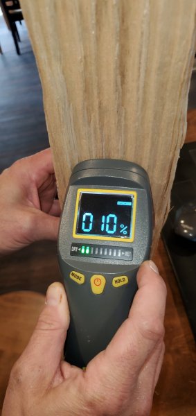

    10% !!!

    Splits that dry hardly need kindling

    Oh! That’s too dry! :rofl: :lol::rofl: :lol::rofl: :lol:

    Have you had that in the house for a while?
    Hard to believe 10% MC in PA this time of year...or really almost anywhere that isn't a dry desert type environment.
    Hey, Daryl Lamppa of Lamppa MFG (Kuuma furnaces) and his manager Dale have both told me my 3-5 year CSS wood is too dry! JRHAWK9 has heard the same from them too...their recommended MC range is 18-28%...this is from the guy that invented/builds the cleanest burning hot air wood furnace on the market...not saying that I've personally noticed that 20% plus wood burns better than sub 18% in these things, but I dunno...the gassifier boiler guys will tell you to not load too much uber dry (sub15%) wood too...

    Not in the house, and thats a fresh split.... 3 layers down from the brown metal roof of the wood show.

    Wow, right on with wood that dry. Driest Ive ever seen was about 16 % on fresh split stores outdoors undercover. That’s in coastal CT so the humidity is always a little higher here. My usual dry stuff is 17-20%. Been burning stuff closer to 25 to get it out of the way. Burning more wide open and will check chimney sooner with that stuff.
