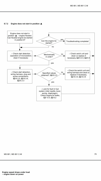

    Start position is choke on m-tronic. They've notched the choke plate to provide just enough air to idle. It can be flooded. Screenshot_2017-05-03-22-51-44.png Screenshot_2017-05-03-22-51-57.png

    It could indeed be the carb solenoid. I would think there would be some running issues as well however if it was indeed the solenoid. I highly doubt that it's a software issue, as the same software is in thousands of saws that work flawlessly. The microswitch mentioned in the troubleshooting charts would be highly suspect as this is -only- an intermittent starting issue, and the OP has indicated that once running, the saw operates normally.
