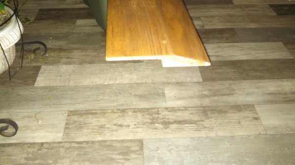

    I made an Oak threshold for the living room/stove room transition several years ago, and it's being refurbished to hopefully last a few more years.
    Pretty sure I just used a few coats of water based MinWax poly on it the first time, but I'm wondering if there might be a better product to use this time around. It gets abused with traffic from the front door many times/day......and we live in sand.
    All advice welcome. Fire away.

  12. papadave
    More gooder info. I put the first coat on this afternoon, then got more of the T&G pine on the ceiling.....did more cleanup and brought some of the cut up cutoffs into the house for kindling.

  15. papadave
    leoht , that would seem to be ideal for a deck or other outdoor use. I'm a bit more concerned with wear and tear on the Oak, so need a durable coating.
    Went out early this morning and put on another, thicker coat after a light sanding of the first. It's taking a bit longer to dry, as I've only got the temp in there set at 45. If this coat takes too long, I'll crank up the stat a bit.
    Yep, thought about that too H. I forget the brand I'm using, and don't even remember buying the stuff, but it's just a WB poly. I'll apply at least 4 coats, then let it cure for at least a couple days before installing. Might bring it into the house for the cure......it's already being heated. :thumbs:

  18. papadave
    Well, thicker is a relative term. :yes:
    I just laid down the 4th coat, and might do a 5th first thing in the morning. Younger brother and I had a shop back in the day and his attitude with finishing seemed to be, if some is good, then more....a lot more, is better. Yeah.....no. Especially when you have a customer waiting on a cabinet. :hair:
    Many thin coats/layers is much gooder. I'm also doing a light sanding between each coat.
    Under/back cut is 3.5", and the bevel is 2.5"...overall width is 6 5/8". Length (width in the doorway) is just about 6'.
