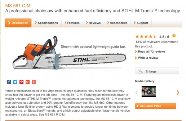

    Get yourself one of these..... the bar and chain are included for free... then send it out to Mastermind to get some extra bananas. There, did I spend enough?

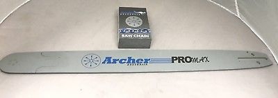

    s-l400 (4).jpg 58.95 shipped ebay
    I've got one no problems

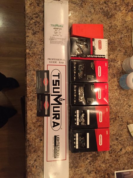

    I ended up making a purchase at Nate's store. A 24" Tsumara bar, 4 full chisel Oregon chains, 1 ripping chain and a plastic wedge for good measure. The package is expected to deliver tomorrow and the trees are slated to come down Tuesday and Wednesday after the holiday. Long range forecast shows lots of rain next week, hoping it doesn't delay the process.

    Came a day early.
