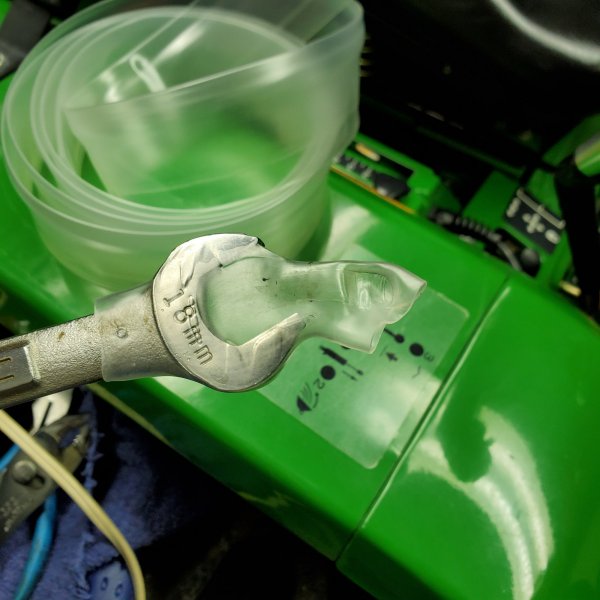

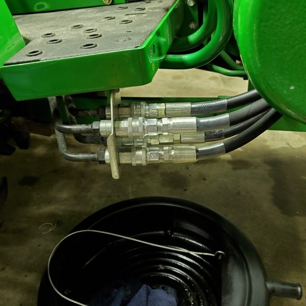

    When I went to install my 3rd function I had to fiddle with the quick connects because the balls were full of grit. I found this stuff on Ebay. It's thick, tough and shrinks tight. A piece soaking in hydraulic fluid so far seems unaffected. I engraved the port numbers on the nipples and tossed the crappy colored caps.

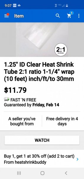

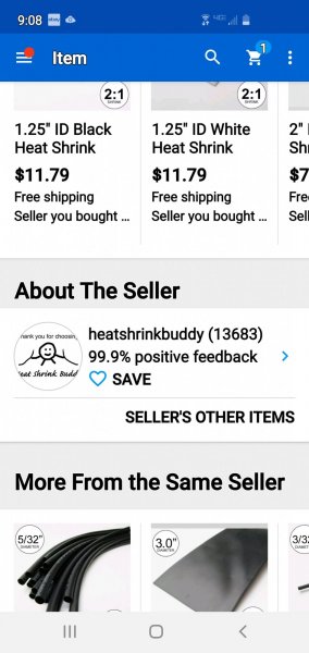

    This is what I bought and the seller.
    Sorry I don't know how to link it.
