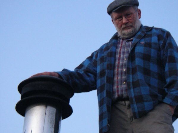

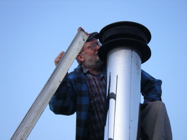

    These pictures were taken with Jetstream boiler at the middle of a batch burn , burning wood that was less than 7% moisture content definitely not burning any water here !
    These are Gasifier 's favorite pictures !

    I'm not sticking my nose in my exhaust pipe !
    People often believe whatever they need to believe and facts be dammed.

    Wood that’s less than 7 percent mc? Is that reading from middle of the piece of wood?

    The middle. The woodshed is over top of the boiler room with a good cross flow through the wood. Also the woodshed is on the South East end of the attic with the summer wind from the North West so all the hot air from the attic is forced through the wood. The wood can also sit up to four months in the boiler room before being burnt. This all equals some very dry wood.

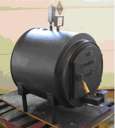

    This was our first wood boiler (similar in principal to most OWB's) it burned 22 cords in its first year of operation. Things done wrong to achieve this total were firstly burning green wood and secondly plumbed it parallel with the cast iron oil boiler to take advantage of the domestic hot water coil and controls of that boiler. This proved to be a heat draw of 350,000 BTU's a day.

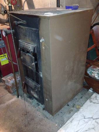

    This was our second boiler - a cast iron downdrafter. It burned 16 cords a year in the same configuration as the first boiler. Again burning green wood and being plumbed in parallel with the cast iron oil boiler helped achieve this high consumption total. When this boiler had 1000 gallons of storage added to it, its consumption dropped to 10 cords per year.
    When the high efficiency Jetstream replaced the Tasso, consumption dropped to 3 1/2 to 4 1/2 cords a year enough that our woodshed that could hold 10 cords allowed us to get ahead on our wood and start burning dry wood.
    The installation instructions that came with the first two Boilers were laid out to make the installation as easy as possible and in my opinion, they never considered efficiency. Also the need to burn dry wood was never mentioned or stressed. The Jetstream manual dedicated three pages of the manual to the burning of dry wood.
