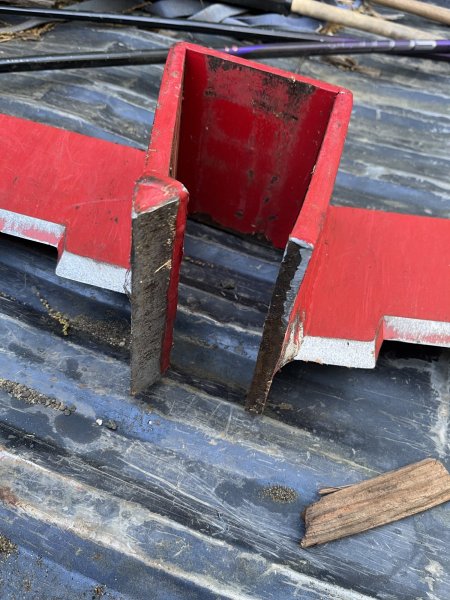

    I don’t give up but the 4 way wedge did today. I have a good welder just a few miles down the street. It’s funny this wedge crapped out because the 6 way has probably done 90% of the splitting.

    Looks like that's been ready to pop for a while now...

    If it’s any consolation a good welder will have that better than new.

    I have no concept of welding costs. Curious what it would/will cost to fix that?
  7. brenndatomu
    23,514
    151,256
    A buddy might charge $50...a shop might go double, or as much as quadruple, depending on their rate, what they do to it exactly, and if they grind out/reinforce the other side or not...chances are it's compromised too.

    I would charge around $100-120. That weld had zero penetration. I would grind it out, vee both sides and put a good hot bead in both sides.
    Poor manufacturing right there. You can see the rusty metal where the weld never made it.

    I am anticipating $75 -$100 but I haven't dropped it off yet. Was hoping to over the weekend but it just didn't happen.

    Wow that’s an incredibly kind offer! I have never met you but you sir are a good man!! I dropped it off to my guy about an hour ago. He said he may have it ready for me tomorrow. He couldn’t believe how bad the factory weld was as many of the guys in here have commented.
