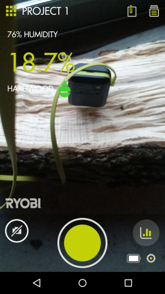

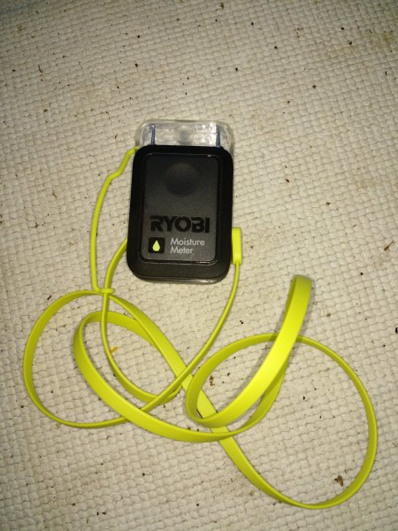

    Ok. Here is the mm. I snapped a photo in the app of me testing another fresh split piece. 18.7%. IMG_20150330_185014754.jpg

    Screenshot_2015-03-30-19-02-50.png Ok, here's a screen shot. The 19.7% before was the highest reading on the wood I sampled.

    You plug the headphone adapter into your phone, and you use the app. The phone screen is the display, and you can track samples over time. It datalogs for you. Or you can simply use it as a simple plug it in and test.

    Stick in some wood furniture in the house to see if it is running true, it doesn't sound like it is if it is reading that low on fresh cut wood....:hair:

    I thought the first pic you put up was missing a piece of test specimen- then I read what you wrote:binoculars:.....

    Remember, it's ash. It's very dry even green.
    I tested a super dry piece of wood that's been in stacks for ~5 years, it was 8.6%. A small cheap wood step stool that I use as a drink table measured 10.3%. That stool is always getting wet from drink condensation, and my Brittany (dog) licks it all the time too. I have no idea why she does, but she does.
    I think it's about right. I know backwoods savage has mentioned that fresh cut ash is in the low 20%, and I got it before it sapped up.
