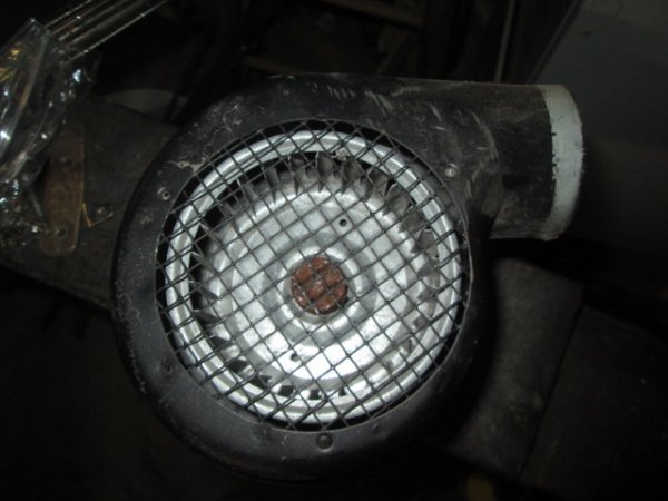

    After rummaging, cruising the internet and ebay, and the like, I finally found a small electric blower that will work PERFECTLY for my antique forge, in the oddest of places to boot!
    I was looking for small, hamster cage-styled blower for my forge. It DOES have a hand operated flywheel blower which is quite an interesting setup for a forge that old (somewhere around 1865-1880), but for continuous stoking of the firepot while working alone, I wanted an electric fan while using it at home in the shop. I ALSO wanted something that I can maybe "split" the air and take half of the air and make a 'venturi' to draw smoke up the flue pipe from the forge shroud. Anyway, I'm planning on making a split manifold that will have an adjustment to allow me to control the air to the forge/venturi pipe.
    Oh, and as to where I finally found the blower? Way up in the woods at Scout camp, in the rafters of the cabin! its a small Dayton fan, probably from the '50s, plugged it in and it runs like a champ!!

    That is a good find. I went from a small noisy hair dryer that was overpowered to a small cage fan. It has a 2" outlet that fits perfectly into a fernco and then the 2" iron pipe fitting. I found the fan on the bottom of a broken air hockey table that was sitting next to a dumpster. The fan is very quiet, and to regulate air flow, I open the ash dump lever at the bottom of the "T" from the tuyere to spill out air. If I use bituminous coal, I shut the fan off when a piece is done being workedon, as bit. can stay lit for a little while. I use more anthracite to be a good neighbor and keep smoke down, so the fan runs constant.

    Jon, that's almost EXACTLY what my fan looks like !
