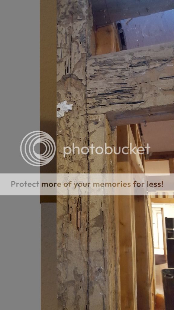

    I got a call to take a look at a structural problem with a house. A younger couple bought a ranch style house 5 years ago.
    They put new shingles on last year then decided to work on changing the kitchen and family room walls.
    When they pulled off the drywall they found some unwelcome visitors. Termites!
    Here is a door header for example.
    There is damage from the basement to the roof. From one end of the house to the other. Walls, floor and roof joists, sill plates, sub-floor, everwhere.

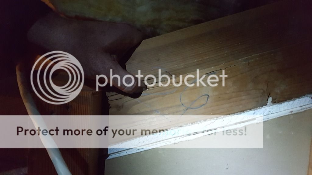

    Here I am pushing...yes pushing my finger into a roof joist.

    Unfortunately the damage was so severe and so extensive to the structure I had no choice but to recommend they pull the house down, rather than try to repair it.
