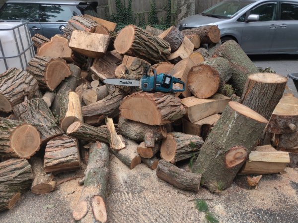

    So I have been filing my own chainsaw chains on my Makita 14" XCU03 36V cordless. I'm so happy I got this thing. Having already been a fervent supporter of the Makita platform I already own a ton of batteries (but that didn't stop me from getting even more), it was an easy decision to go with this saw.
    Initially when I started sharpening, I made all the rookie mistakes. I used the wrong size file (twice), I oversharpened, I didn't file the rakes, my angle was off and I ended up breaking a few chains because I filed the links by accident and basically I wasn't doing a good job of getting the chain sharp.
    After watching a lot of Buckin' Billy Ray Smith videos on youtube, getting the right file size for my chain (even though Makita says one thing and Oregon says another), I'm now using a 5/32". Not only did I make the mistake once but I guess I made it twice because of the confusion and also tried a 3/16" file but that was also too big.
    I tried using the Stihl chainsaw sharpener initally and that came with 13/64" files (says it's made for 3/8" pitch chains) but that was way too big.
    Just bought a stump vise because getting into my garage (I mean shed for all intents and purposes) with the splitter, generator, wood chipper, 4 bicycles, 3 scooters, and god knows what else was super cramped using the bench vise.
    I like the bench vise because it forces you to not use so much......force.....I had a couple of rounds piled on top of each other to get a comfortable height to work with.

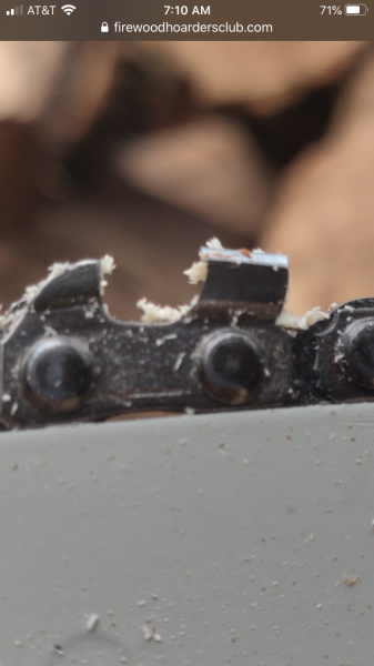

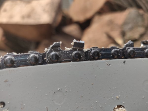

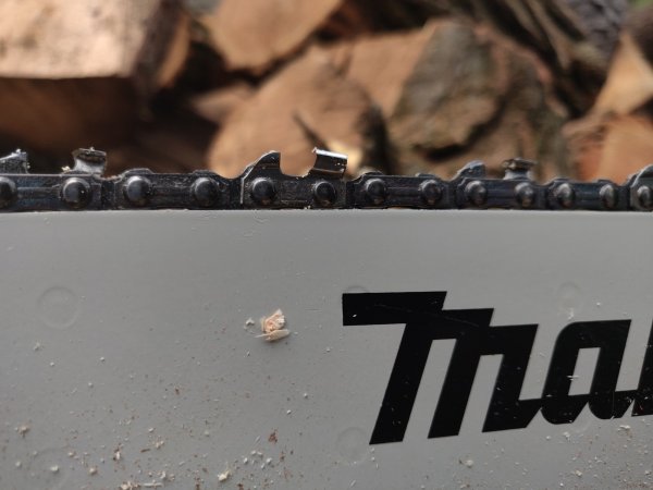

    I think the chips speak for themselves...when you can sharpen a chain and get chips like that....and make 6 dozen cuts through cherry, black locust, linden, pine, spruce, and still just need a slight touchup with the file, I call that progress.
    I just bought 12 new chains....hit a couple of rocks whilst cleaning up after Hurrican Isaias....trashed a few chains.....and now I finally think I have enough chains to keep up with sharpening......and yet be able to whip out a new one just in case of an emergency......Bought a new bar and have a spare on order. You never know when a bar is going to get trashed.....

    I have a stump vise, but I'm not a big fan of them. I think they would work best on really small saws like yours. Big saws have too long of a bar, and the heights often don't match up with the stump vise opening. Balance can also be tricky. Especially if big dogs are used. I ended up using a small vise I got at a flea market and I mounted in to a receiver tube, so I can slide the vise into a 2" receiver.
    I wouldn't mind having a little lightweight battery saw for those times when you don't want to start up a gas model, and for small de-limbing jobs.

    Ah that makes sense. Yeah the Makita is nice and light.....even loaded up with (2) 5.0 aH batteries....and man that thing rips now. I've used it on HUGE rounds 28" in diameter and while obviously not as easy as a 14" round it still got the job done. It's very quiet, the batteries last quite a while once you dial in the chain tension properly. Initially I had my chain way too tight which ran the motor down way quicker than now.
    I didn't want a gas one because it's just more maintenance with the oil and fuel mixing and I felt with all the batteries I had it just made sense to get this one.
    With the low profile chain I haven't really had much kick back at all. I still wear chaps, gloves, and a helmet with a screen at all times. I have no intentions of becoming a statistic. I've used it for de-limbing as well but don't be fooled by it's short bar....this thing will do some damage, albeit a little slower than the big gas boys......

    How big are those rounds and what size bar?

    The bar is 14" so the rounds are all around there or a little under that in this pile.....

    IMO this cutter needs more hook, so the file should be overall lower in the tooth.
    This would help the chain “self feed” better.

    Yeah I will do a better job of that. Thanks for the input.
