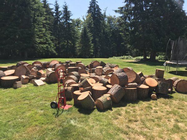

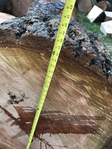

    Scrounged two large Douglas fir trees. Probably around five or six cord worth. The largest round I could find is just over 36”. I feel safe on the splitter up to around 30”. The larger stump rounds were blocked at the job site. Now I need to hurry up and Get it split to catch these next two months of summer that finally came.

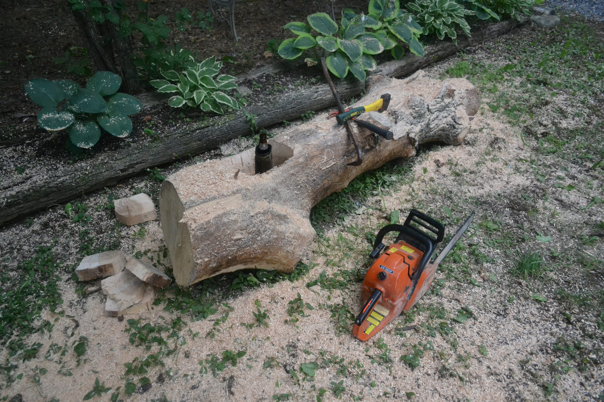

    "I usually use my 2171 for noodling with 3/8 full comp chain. How well it works depends a lot on the angle your cutting and that you leave a few inches between the wood and the power head, so the noodles fall away rather than get drawn into the clutch. Cutting with more angle, as opposed to parallel with the grain will shorten up the noodles also and help with the clogging problem. I cut my wood at about 18". If you cut yours much longer, it's possible you may benefit for skip chain, but I'm not sure."

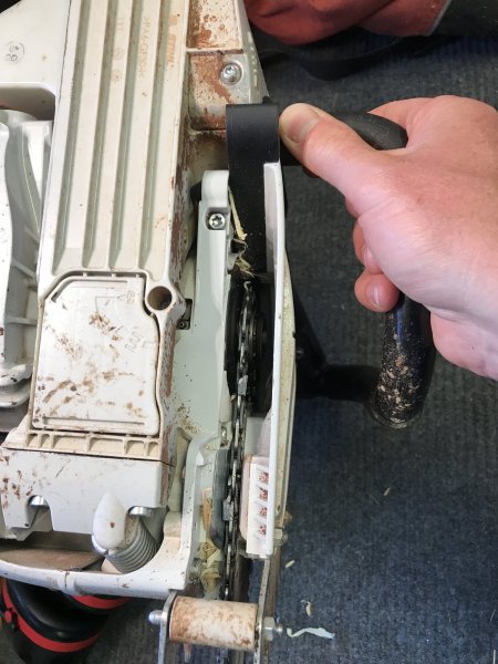

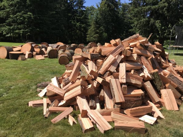

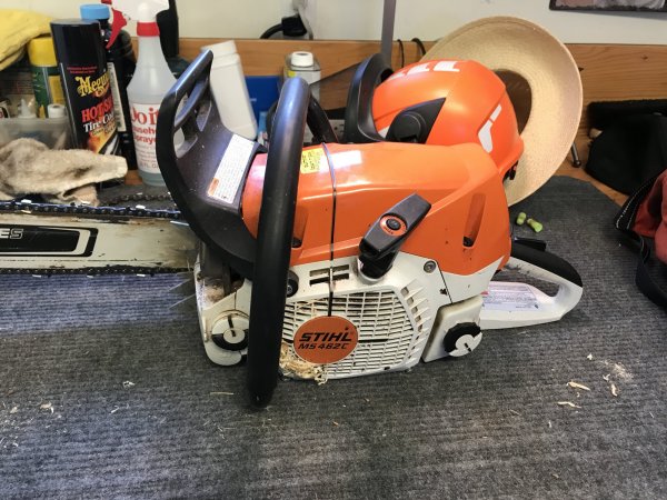

    Made a big dent in the pile today. I’m running Stihl RSF and RMF chain on a 462. It’s does not plug and runs clean When noodling. This power head dulls chains very fast on imbedded nails!
