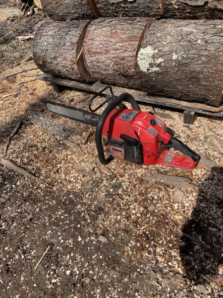

    Several weeks ago I came upon a Shindiawa 575 chainsaw with a 20” bar and chain. Free if I wanted it. It had sat in a barn unused for at least 15 years. I was told it didn’t run and was too heavy for the older man to use. It looked pretty rough covered in years of dust and grime. But the price was right and I figured “what the heck”, if it’s junk nothing ventured.
    At home under closer inspection found that the fuel line was shot, fuel filter plugged, carburetor gummed up, small hole in the gas tank… just an oily, grimy mess! The piston and cylinder walls looked great and spark plug looked good. Upon pulling there was spark. So… took it apart and cleaned the whole saw, cleaned and rebuilt the carb, new fuel filter and line, cleaned the air filter, JB Weld on the fuel tank hole, flushed the tank, cleaned the bar, sharpened the chain, tuned it using a tachometer… it runs and cuts great!
    Except… and here is where I’m perplexed… whether it’s the first start of the day or starting five minutes after running hard for a half hour… unless you let it sit and idle for a couple minutes it bogs badly upon acceleration. After it sits and idles for a couple minutes it runs and cuts like a beast! This happens every start, every time.
    What could be the problem?! I really like this old saw I resurrected. Sorry for the long post

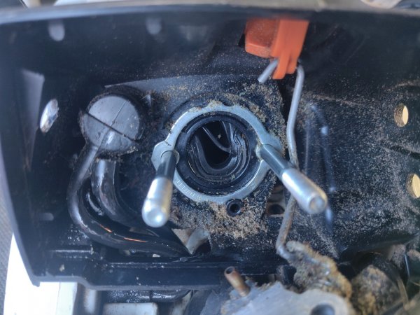

    I had to fix this saw for my buddy. Wouldn't start and it was a massive air leak because the intake boot had popped out of place. Saw must have been dropped. Stihl MS193T.
